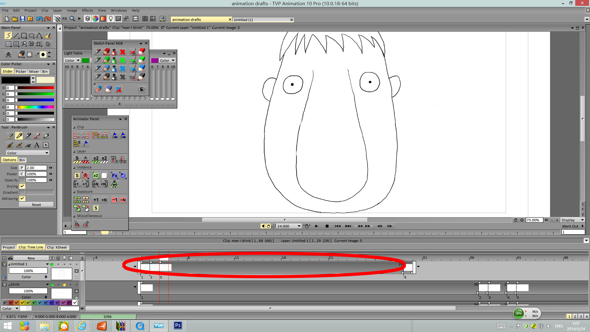

When on the same layer, there are two parts, and I would only want to apply the Ping-Pong effect to the first part, for example, from frame 1 to frame 30, but not the frame after that. How do I do it?
I know it would work if I just apply it to the entire layer by making the last frame "Ping-Pong", but that's not what I want.
I have attached a pic.
Does anyone know how to solve this ?

There is a function called "Faux-Fixe" what is exactly doing that. Search in the forum or read the manual about it.

In addition to using Faux-Fixe, you stop the Ping-Ponging at a certain point by placing a new frame where you want the effect to stop. The new frame might be the first frame of your ping pong or anything else.

ok I finally got it. Have to set the faux fixe value in order to make it work
