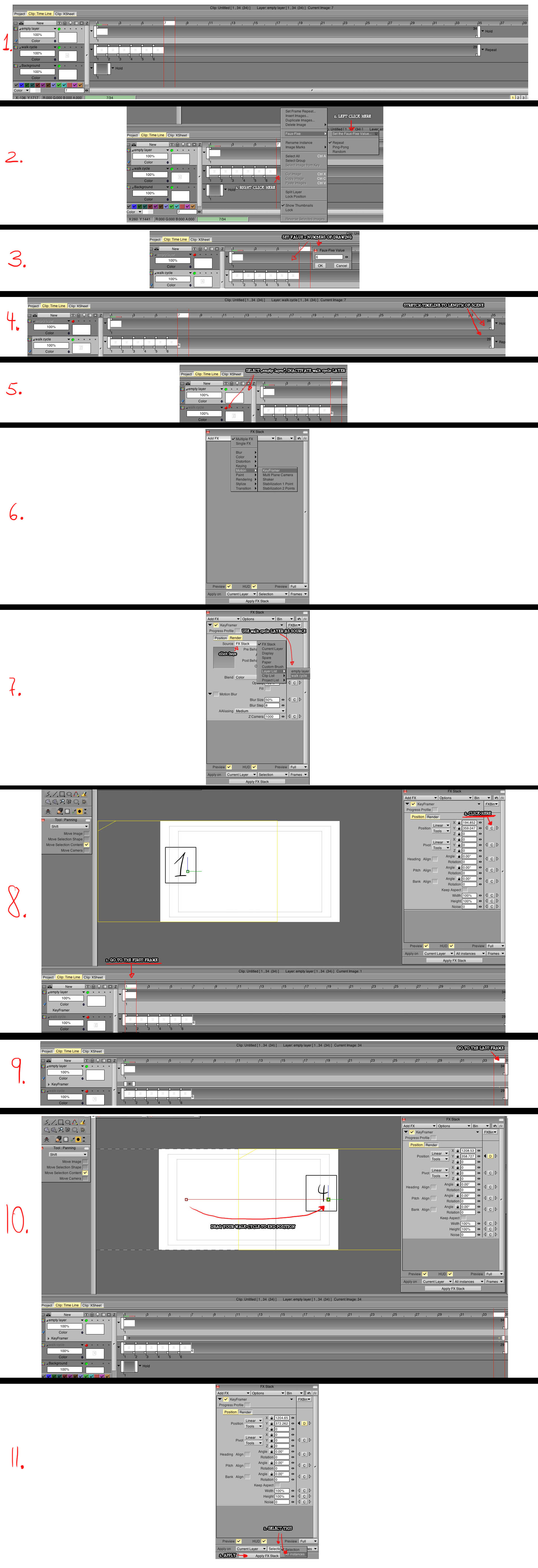

maybe this helps (step by step keyframer tutorial):
alfatoons
Posts: 53
Joined: 21 Oct 2010, 12:16
Re: Camera tool pan and zoom?
Post by alfatoons »
YES yes yes....
Furushil!!!
Truly and really thank you for taking your time to do this. This is exactly what I was thinking and looking for.
You know I´m new to TVPaint. Tryed it out long time ago left it and now came back to "crack the nut" sort of speaking.
I do not mean to diss any software developer. But It is a puzzel to me ,that most of all the software aimed at making animation, is constructed in a very complex way to use. Atleast for the user,In my opinion.
I see in you example that I have to go thru 11 clicks or steps to achieve a simple thing like this little pan that you showed. And it would be like a walk in the jungle for a new commer, traditional paper and pencil animator like myself, to figure out that I ctually had to go thru 11 steps to achieve this. And I do not see a clear example in the manual.
It is , in my opinion , such a great feature to have, easy at hand, when you want to show clients your idea. Instead of trying to explane all the movements.They usually do not understand:(
furushil. I will keep your picture as refence nd I thank you. I will most likely return with other questions...
