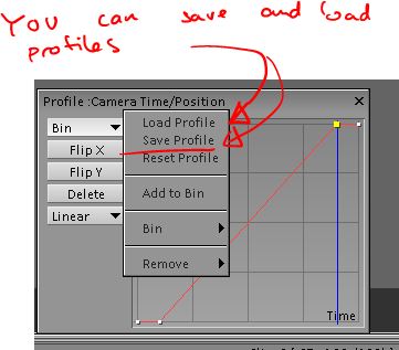

I can actually save and load a profile manually pretty easy here
save load profiles.JPG (27.56 KiB) Viewed 2495 times
And this is the content of the file if a set the camera movement to start at 10 and end at 90
Code: Select all
[Curve]
point3=1 1
numpoint=4
name=Camera Time/Position
current=2
linear=1
point0=0 0
point1=0.1025 0
point2=0.9025 1
it looks fairly easy to manipulate. It is actually all that I would like to have George access to to save and load the profiles of the Camera Time/Postion
