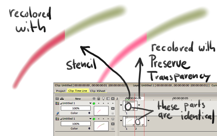

Markus, let ME try again...
The thing ist gerade that they are NOT calculated in a different way!
i tried explaining it here
the difference is that they are displayed differently and this follows simply from the fact that in one case the result is ONE layer
and in the other case (Stencil) the result is one Two (or more) layers
see image:
What i didn't mention there is that they both already use the same alpha mask.Peter wrote: it is not a bug.
When recoloring on a layer that is itself in stencil mode, this will always happen.
The "artifacts" are caused by the anti aliased edges of the original drawing, the antialias pixels are partially transparent (thus the mask edge is partially transparent) and therefore when you apply color on the half transparent pixels the new color will only be applied with half opacity.
Therefore it results in a mix of both the new and old color. When the old color is darker, a dark halo will appear.
That is why if you want to perfectly recolor the layer itself you'll have to use the preserve transparency function.

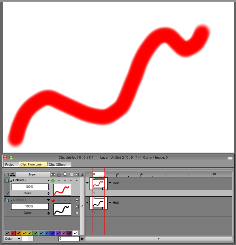

Yes, because you are not supposed to paint on a layer using stencil mode, but on a different one.slowtiger wrote: Sorry, I don't follow that. There must be a technical difference since recoloring the same layer will yield different results when applying transparency preserve and stencil on itself.
You modify lines' colors on current layer = use preserve alpha
You want to change line's color, but having the result on different layer = turn the original layer into a stencil, create a new layer and paint on this new layer. I also advise you to turn off the original layer.
Result is the same : all depend on the way you work.

o.k. here is one last try to explain the difference:slowtiger wrote:Sorry, I don't follow that. There must be a technical difference since recoloring the same layer will yield different results when applying transparency preserve and stencil on itself.
Preserve transparency lets you replace the RGB value of ALL present pixels equally, no matter their transparency.
i think this is simple and clear.
Stencil gives a different result when you try to recolor on the layer itself.
This is not because the alpha mask of the stencil is different.
but its because you cannot replace the RGB value fully through a halftransparent mask.
o.k. lets try an example:
you want to paint a 50% transparent pixel from black to red
PreserveTransparency simply allows you to turn the RGB value of this pixel from black to red and because of the alpha channel, which is still at 50%, the pixel has become a 50% transparent red pixel (hurray!)
Stencil however is a different story, a bit more tricky to understand.
When you apply 100% red "paint" to the 50% black pixel, it won't turn into a 50% red pixel because the pixel is its own mask!
because of the stencil mask the red "paint" is blocked from reaching the 50% black pixel by its own 50% transparency, only 50% of the "red paint" comes through....
The half transparent pixels in the stencil mask prevent themselves to be recolored 100%
the more transparent a pixel is the less it can be recolored
that is why you see the effect mostly along the edges of lines, because of the anti alias these edges are transparent.

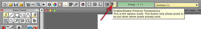

Re: Problem with coloring lines by hand
The location of the Preserve Transparency button in TVP 9.5 is at the top. See attached screen shot.drude wrote:Hello!
I am very fond of the preserve transparency mode in tvp10! i use it all the time. I am now working on a project where the current type of TVP we use is 9.5 - and now my problem is, that i don't know where that button is! - is this feature not part of TVP 9.5? And if it is, does anyone know where to find it?
Thanks!:)
THANK YOU! i completely forgot where it was, i was sure i had used it in 9.5 before - perfect! Now i remember!
