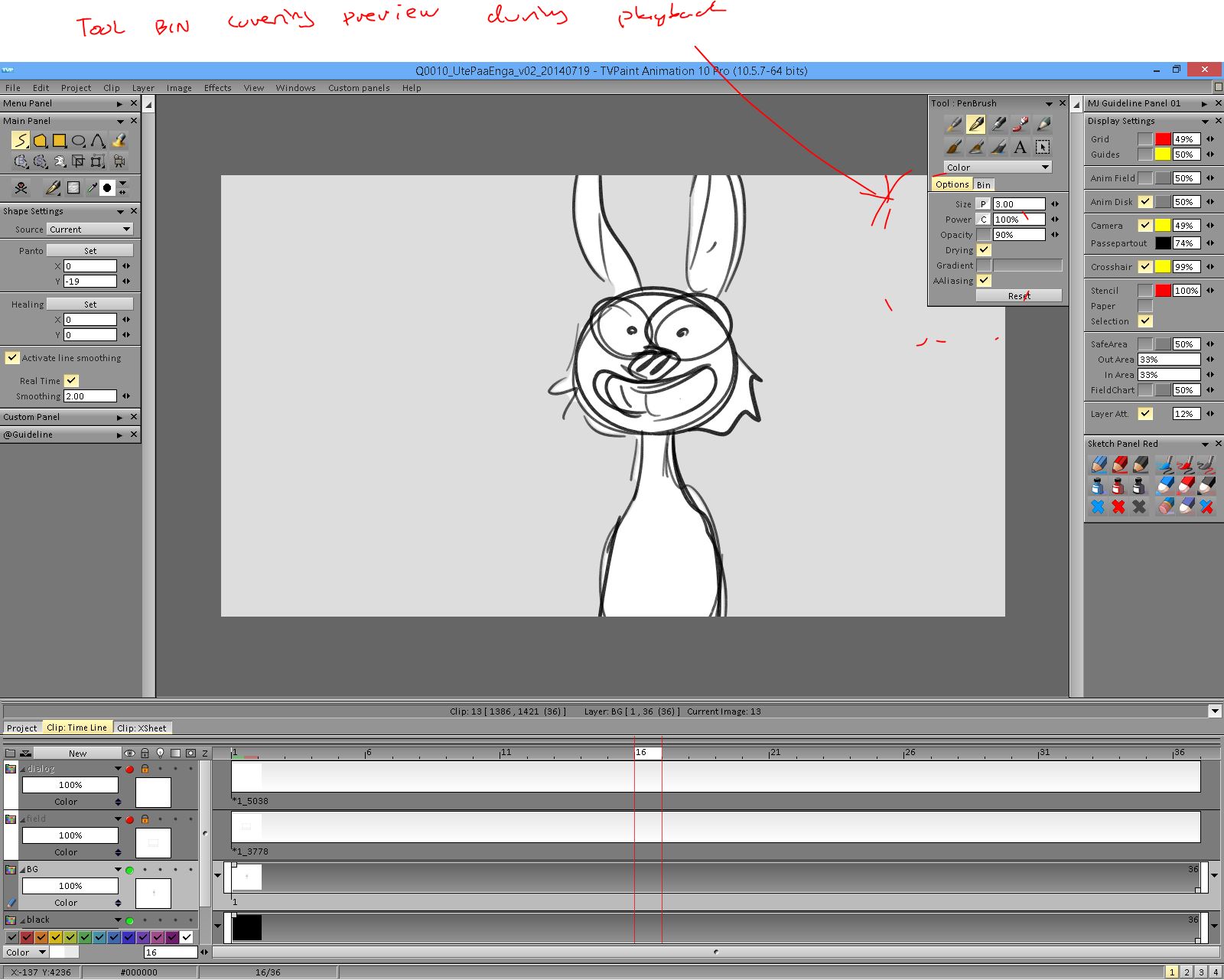

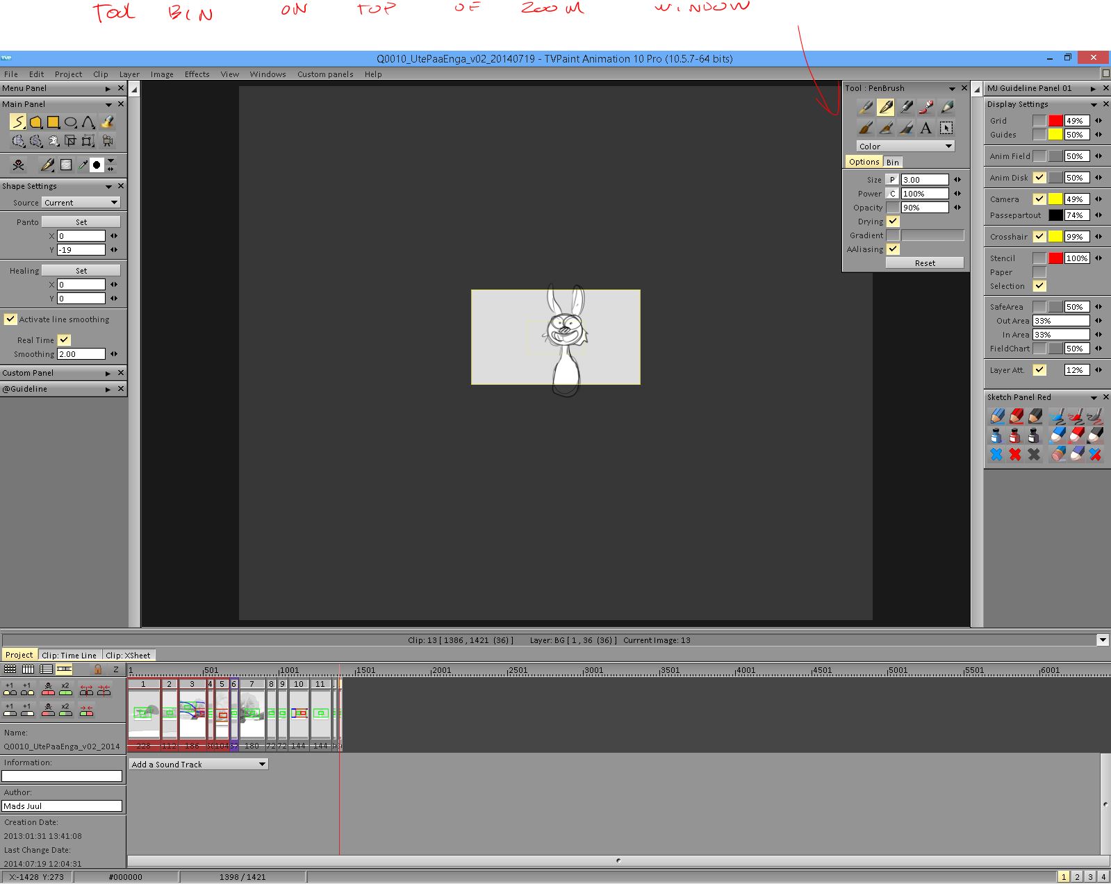

Re: camera view during preview
I have the same problem that my Custom panels is coering my playback because I work with viewF>FullScreen and have my ool Panel on top of my Zoom Window because I am right handed and this is a nice place. and my right bin is full of custom panels like this.furushil wrote: I am working on a scene and the zoom is set to 50% in the navigator. The "play with camera view" is enabled. When I hit preview, the zoom jumps to 100% and the canvas is centered. The problem is that my custom panels are covering areas of the preview.
When previewing my Custom panel is covering part of preview A solution could be if the preview could respect (take notice of and find the best Zoom window playback)the Panels on top of the Zoom Window. Something like the playback is respecting the bins if the side bins is collapsed the preview is bigger than if it is uncollapsed.
