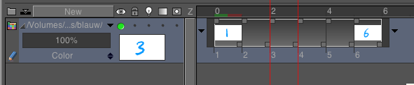

When I import a sequence with tv_LoadSequence, it only shows the first and last image of the sequence in the thumbnails.
Is there a way to somehow update the frames in between? They don't show up when drawing in them either. I'm not sure what's going on. :(

Lukas wrote:When I import a sequence with tv_LoadSequence, it only shows the first and last image of the sequence in the thumbnails.
You have to select Show Thumbnails in the layer menu (RMB click the layer).
I think for some reason this is not default when using tv_loadSequence. And I don't think it is possible to enable "Show Thumbnails" With George.
