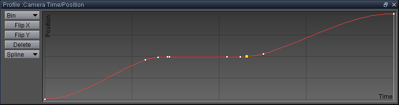

To stop your camera, hold in the middle, and finish the move isn't that difficult. First learn to understand the function of the Time Profile.
Click on it to bring it out into a free floating position.
Move it to your layers panel and stretch it to match the length of the entire timeline.
Notice where it says "Position" (on the left) and where it says "Time".
To test the move, keep your graph setting in its default state, which will be "Linear"
Look at the blue. diagonal graph and click somewhere in the middle (closer to the left) and click in the graph to create a key.
Do the same a bit of a distance to the right and drag the graph down so that it will create a perfectly flat area between your two keys. This will be your stop (or hold).
The rising part of the graph's beginning is a zoom (note Position/Time and how it indicates a gradual change in camera position over a span of time).
The same applies to the diagonal portion of the graph at the end.
Thus you have a zoom, hold and zoom.
Play with this and when you feel you understand what's going on, let me know and I can explain how to create a slow in/out etc.

David_Fine wrote:... I want to zoom in, stop, then move to another third position. I can't seem to make it go from A to B and then C, only A to B and then back to A (or towards A). Am I missing something? ...
you probably have to clic somewhere else to add the third C point of the path, then, on the progress profile, use a flat portion when you want to stop.
but I must admit to mix horizontal straight (flat) and spline (curve to ease-in or out), it's not so easy, I mean it's really trickky ...

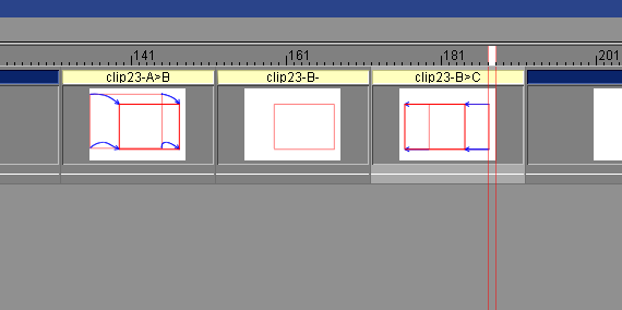

so I personnally feel more comfortable by taking the way of splitting the clip in different clips,
one for A to B cam move, a second one for B without move, and a third one for B to C.

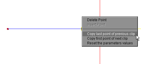

indeed, f.i. here's a 3 parts camera move on 60 frames :
1) the first 20 frames : CAM. A to B = left to right pan + small Zoom-in (with ease-in and out),
2) the next 20 frames : CAM B = still camera (no move at all),
3) the last 20 frames : CAM B to C = right to left pan, no Zoom, (with ease-in and out),
by splitting my initial clip in 3 sub-clips, the camera move become very simple to set up,
simple, since we have got the (RMB) commands to copy the Camera point (X, Y, Z) from one clip to the next :
8)
