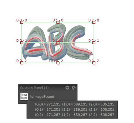

Below is the tvpx with a button/script that measures, then displays a bounding box around the image plus gives the x1,y1,x2,y2,xmid and ymid values for the bounding box. Plug those into the destination x,y points using the 3x3, FX warping grid.
Once you've plugged in the nine FX-WarpGrid Destination coordinates, be sure to press D->S (destination to source) FX button to copy those coordinates to FX-WarpGrid Source...
Now you'll be able to interactively deform the image using nine, close-cropped points.
Having to plug-in nine-pairs of x,y numbers is a little tedious but I couldn't figure out how to directly insert them into the FX. There might be a way.
Anyway it's meant to be a proof-of-concept that demonstrates how useful having an automatic bounding box option in the WarpGrid and other FX operations might be.
Sven
Edited: to add additional instructions and correct spelling.
