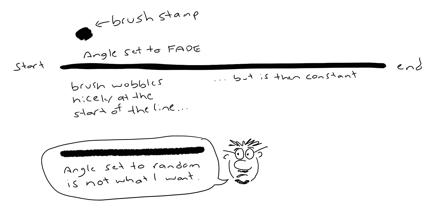

Thanks noodle. I think a roundish pen which has some variety. I think there are some settings which I am not so expert in which can give it something interesting. I was playing with a brush I just made from a simple blob and I set the angle to Fade, which was interesting because it gave a slight random thick and thin to the line, but then went constant. I wonder how I could make it randomly go thick or thin a bit so that it always has some variation, even at full pressure. So pressure would determine the line weight, but at full weight, it would never be a constant. Here is a picture which explains better.

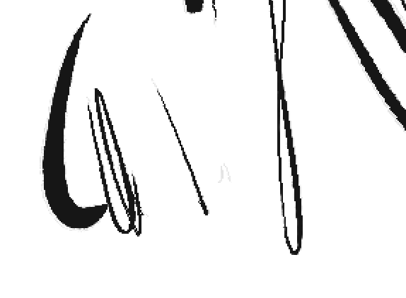

The only downside is that anti-aliasing is off, so you get these hard edges 200% zoom
and if you turn it on the brush gets really laggy, at least on my old MacBook

Ahh, OK. I didn't even realize, since I tend to work at high resolution. I like aliased brushes because they look more "crisp" to me, and the jaggies don't bug me. But you're right, that might make some issues for others. The reason it's so laggy is that there are 360 frames of animation inside the brush. Let me see if I can make an alternative with fewer frames and anti-aliasing intact...schwarzgrau wrote:That's some amazing sketching brush. It's really fast and acts great.

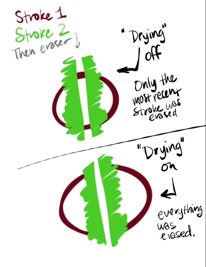

The fringe is there to give it sort of a scratchy texture, like the edges of a nib that don't have as much ink. As far as I know, "drying" means that all strokes made by the brush will be affected by the right-click erasing function. If drying is disabled, only the last stroke you made will be erasable, the rest will not be erased when you do the right-click:

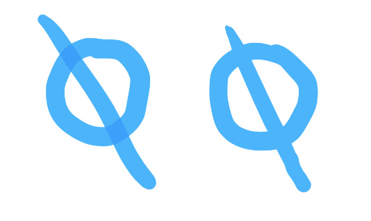

I never noticed the behaviour Zoe mentioned about drying, but it's intersting. I use it together with the power setting of the brush.David_Fine wrote:I notice drying is on, but turning it off doesn't seem to make a difference. What is it for? And why Alpha Max?
I set the power of the brush to constant 70% and drew the left crossed circle with drying, the right is without drying.
