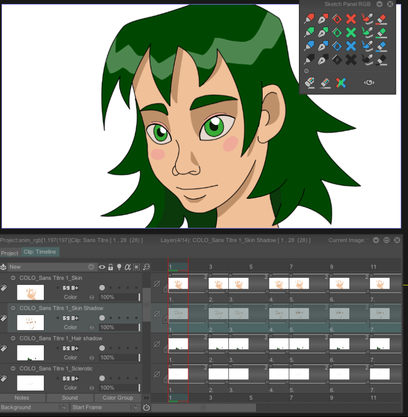

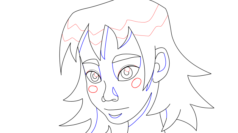

Actually, combining Sketch Panel and CTG Layer does the trick pretty easily :
1) On animation layer :
• black lines will stay black
• blue lines for shadows
• red lines for lights
(or any color of your choice)
(to emulate Japanese style - since they work mainly with full opacity + aliasing, you can use this RGB Sketch panel)
2) On CTG layer : you fill with colors and it won't let any gap between 2 color areas (yeah, 64 bit is not the only reason for using the Pro version
3) Extract colors from CTG layers
4) Hide CTG layer and disable "apply changes"
5) Erase Blue and red lines

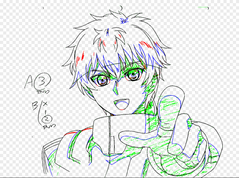

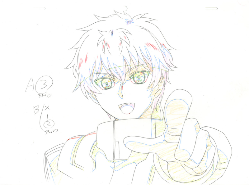

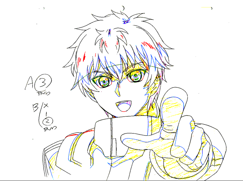

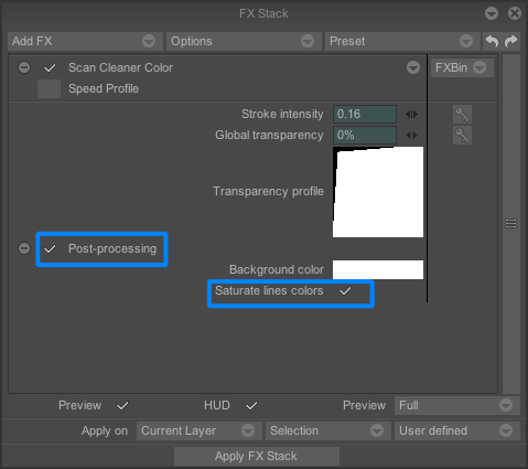

And for the ones who still prefer animating on paper, they can even use the Scan cleaner with colors :

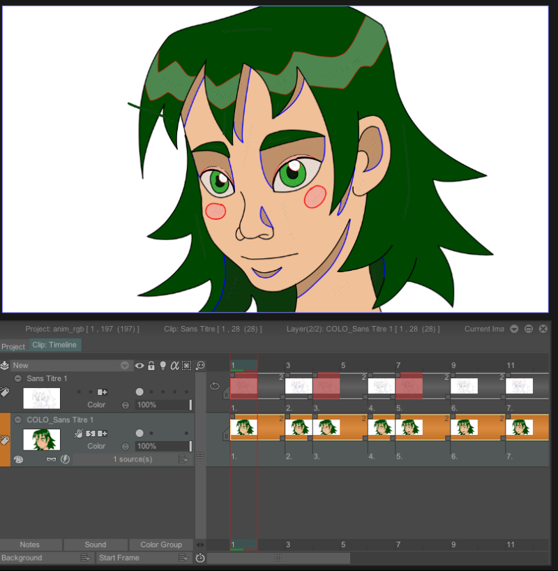

Personally i even put my red/blue lines on another layer than my cleanup and just add it as a source on my ctg layer (that way it's easier to erase it afterward). So you can have the line quality you want for your cleanup, with the brush you want, that means a lot more expressivity and possibilities than vector drawing apps.
And i use another layer above that is a "correction layer" for my cleanup also listed as a source, in case the CTG layer doesn't do what i want. It permits me to keep the cleanup I drew and add contour lines to be sure the color works as i want it to work, it's sometimes painful to use CTG layers with a weird cleanup style.
And on my school films me often used the line colorize FX, that is doing a pretty great job.
Anyway the animation tools and scripts in TVPaint are also onderful, doing a great job having a "traditional animation feel" and ease of use that is hard to find elsewhere (lightable, off the peg, image marks and bookmarks, flips, scripts etc...)

For the video tutorials : I could not do anything regarding the Scan Cleaner Color, since we didn't have the right to use the gengas (key images in Japanim) we found on the web.

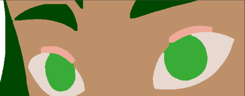

Hi, I took part in that thread and a long time user of Retas. Unfortunately your method described here is far from being a solution and I hope you will take the time to understand why. This isn’t to do with traditions, this is now part of a much more modern process.
The way Retas works is it includes the color separation lines as part OF the color fill rather than using the line to approximate a color boundary under the line. I used your drawing above to demonstrate. In this gif below you can clearly see the level of control we have over those lines. This makes the process not only incredibly fast but also reliably accurate because we know which color will take the lines place.
Now in the gif below I paint some sharp angles using CTG in TVP. The first problem is we have no idea which side of the color will take the place of the color separation line. Will it be the base or the shadow? The second problem is that CTG doesn’t handle sharp angles very well. You'll see those a lot in anime, especially on the hair.
I know this may appear trivial to some people but whether it is me, colleagues or other animators that talk about this coloring method it is often not taken seriously. I've had people from Toon Boom tell me "Harmony can do this if you do XYZ" when it doesn't get close. For a long time where I worked we were using a script created by someone from Adobe that replicated this method in Photoshop. When I spoke to someone from CACANi before the software launch I was told they have already spoken to Japanese studios and this method is a key feature. It would be a huge step forward if it was also added to TVP.

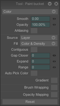

My Solution (a feature request)
I have a way of achieving the same level of accuracy as Retas that is able to replace and include color separation lines in TVP as part of the fill action, the only downside is it takes on average twice as long as Retas, but you could remedy that quite simply I think as I describe below.
So instead of using CTG we use the Fill Tool. Draw your blue separation lines on a separate layer, this layer will become the shadow color layer later.
Take the Fill Tool and grab the same color blue as the separation line and fill as if you were coloring your shadows like normal (on the blue separation line layer). You’ll end up with this:
As you can see compared to CTG we have maintained all our extreme angles and we have achieved the same accuracy as Retas by including the separation line as part of the fill. The next step is to Preserve Transparency to the shadow layer, set the Fill Tools Gap Closer number to 0 and click on the Blue Area to fill with your intended shadow color, since the area is now all the same color it will be easy for TVP to replace. You will end up with this:
Perfect! All TVP needs to do is automate this process. For example by adding this to the Fill Tool Settings:
Those three colors should correspond to the same colors in the RGB Sketch Panel. The way it would function is like this:
> Select your intended Shadow Color in the A/BPen [Skin Shadow for example]
> Tick the Blue Box under Include Color Line
> Click the area you want to fill
> TVP will fill with blue FIRST which combines the fill area and the lines as one shape [Using Normal Settings]
> Then it turns ON Preserve Transparency to the layer
> Forces Gap Closer to 0
> Then it Fills with the A/BPen Color using the Expand setting in the Include Color Line box (or a forced value)
> Then it turns OFF Preserve Transparency to the Layer
> END
If you could nail that down to a single click then that would be it. All you need to do is select the shadow layer or highlight layer when you tick those boxes and you have exactly what Retas gives as a result, to the pixel.
Please consider it.
