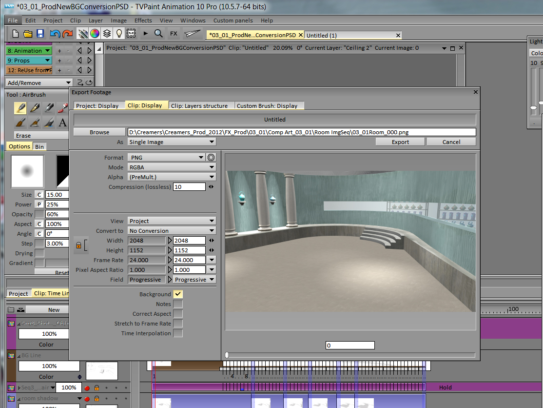

So I am back with this issue which was never resovled. I just put it on the back burner for the end of production.Which is where I am now. TVP is still crashing when exporting PNG sequences. I did upgrade and that did not solve the problem. That said I am still on TVP 10 (5.7) not 11. I don't really want to go to 11 at this stage because of the changes in interface. Sooo the files are large because they have img sequences in them originally brought in from Maya (loaded and saved as dependencies). I have a screen grab of the export settings. I can send you a file via drop box if that would help. One thing I have been doing with these is labeling the file.

Forgot here is the screen grab of the export box..

First of all, I would not advise you to choose "pre-mutliply" mode, but "not premultiply" mode.
Secondly, I would not use RGBA mode if I wanted to export the background, it makes no sense.
And last, but not least, if your computer is not powerful, don't use compression = 10. It asks a lot of power from your machine.

hilary wrote: Forgot here is the screen grab of the export box..
inconsistency :
you are telling us about an"Export PNG sequence" issue (crash during the export process),
but your screengrab shows a "Single Image" export ... :?
did you mean you got also a crash when exporting a single image ?
a last thing, if your crash still persists after following Elodie's advises in the previous post,
(specially the "no-premultiply" mode), try also to rename your folder "Room ImgSeq" into "Room_ImgSeq",
"blank space" in the file path can sometimes be problematic.
