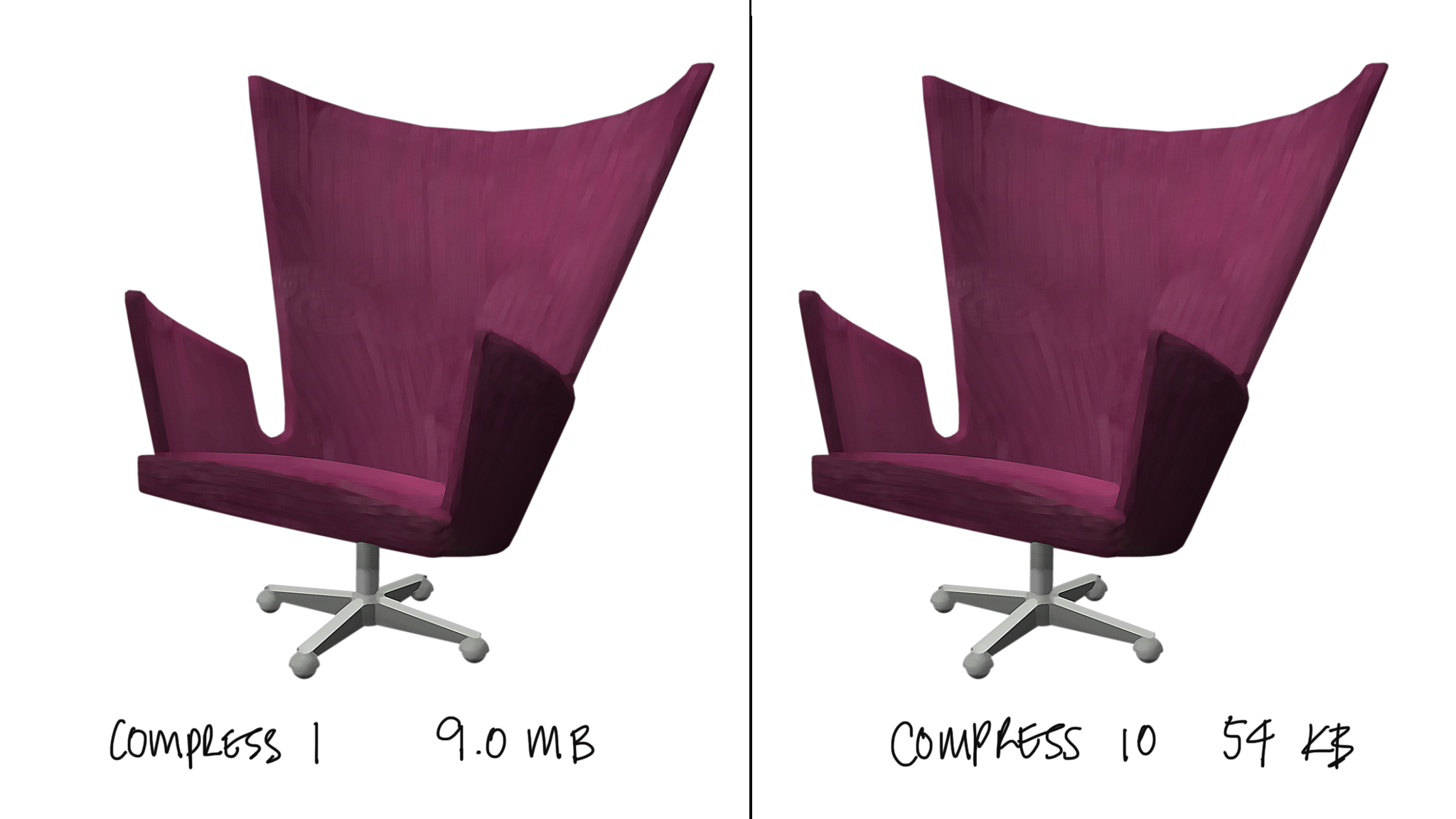

OK - Success! So I think the issue was the RGBA (as well as background being unnecessarily checked) on the BG layer.Plus I would always start my exports with these detailed BG layers. This is the one that has the most info in it. Plus as it would crash I would overwrite the first few files on the second attempt and I think this was confusing the number naming system. It does seem to make a slight difference to make sure there is an under score in the file directory folder itself. So for the most detailed art layer it was:
25 minutes to render 76 frames. At #10 setting each image was 1.8 MB
Overlay layers with less image on them exported WITH an alpha (RGBA) went quickly
2 minute 76 frames. At #10 setting each image was 54KB
BUT when I tried the #1 setting just to see - as predicted the time to render was twice as fast (1 min) but the file size really spiked to 9MB! I looked at them side by side and have to say can't see the difference(see image below) That said at my editors we were looking at an image on a very good monitor as opposed to the cintiq. So will check with him to see but I think I will stick with 10 for file compression if nothing else. Have way too much to do to have a single image balloon to 9MBs.

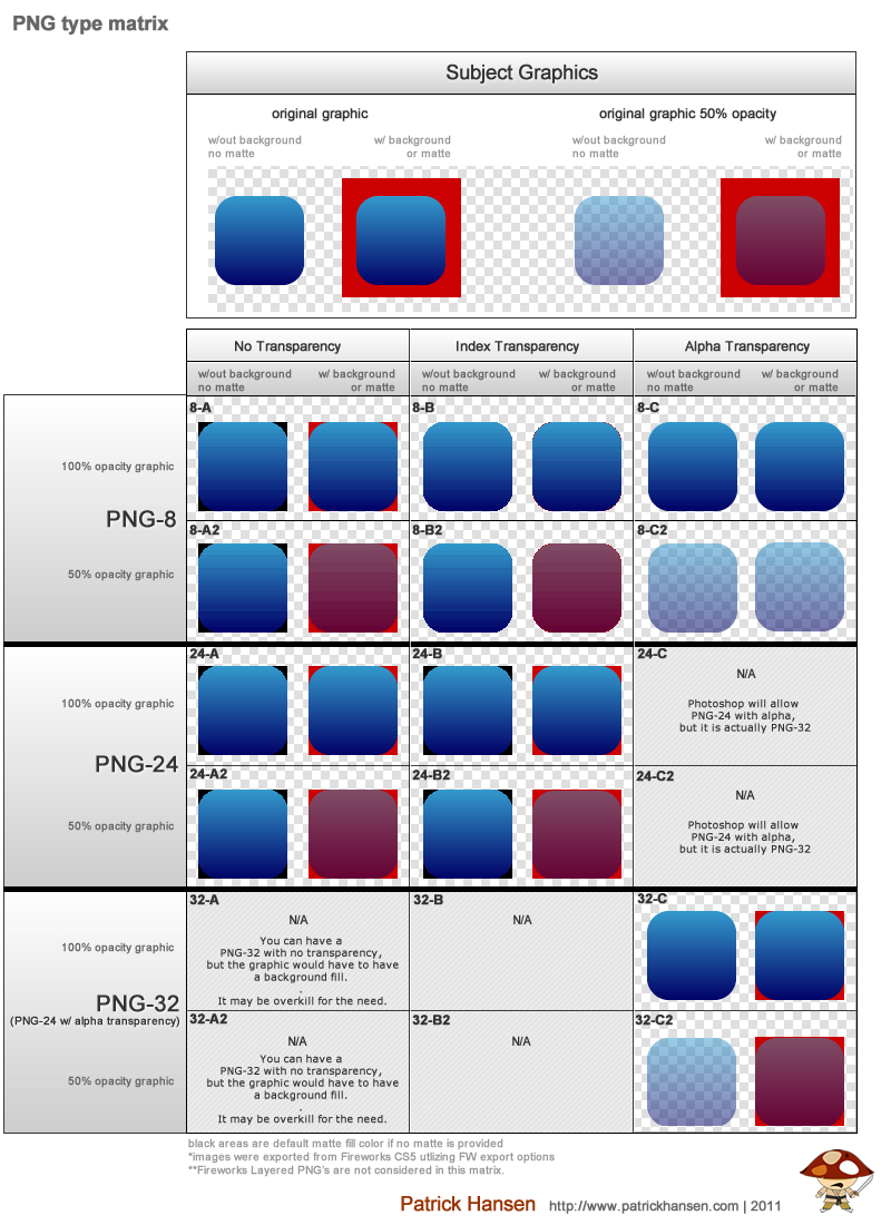

Here’s a quick explanation of the three PNG formats :
- PNG-8 : 8-bit PNG, meaning the image is 8 bits per pixel
- PNG-24 : 24-bit PNG, 24 bits per pixel. PNG-24 can handle a lot more color and is good for complex images with lots of color such as photographs (just like JPEG), while PNG-8 is more optimized for things with simple colors, such as logos, icons, buttons...
- PNG-32 : PNG32 is PNG24 but with support for full alpha transparency. This means you can have varying degrees of transparency for each pixel, whereas GIFs can only have transparency turned on or off for each pixel. Therefore, when placed on complex or ill-matching backgrounds, transparent PNGs will have nice smooth edges.
Regarding non-premultiplied and premultiplied, here’s the official PNG specs ( http://www.w3.org/TR/PNG-Rationale.html ... lied-alpha" onclick="window.open(this.href);return false; ) explaining why premultiplied is bad :
PNG uses "unassociated" or "non-premultiplied" alpha so that images with separate transparency masks can be stored losslessly. Another common technique, "premultiplied alpha", stores pixel values premultiplied by the alpha fraction; in effect, the image is already composited against a black background. Any image data hidden by the transparency mask is irretrievably lost by that method, since multiplying by a zero alpha value always produces zero.
Some image rendering techniques generate images with premultiplied alpha (the alpha value actually represents how much of the pixel is covered by the image). This representation can be converted to PNG by dividing the sample values by alpha, except where alpha is zero. The result will look good if displayed by a viewer that handles alpha properly, but will not look very good if the viewer ignores the alpha channel.
Although each form of alpha storage has its advantages, we did not want to require all PNG viewers to handle both forms. We standardized on non-premultiplied alpha as being the lossless and more general case.
