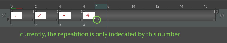

I generally find it confusing that applying the repeat function will apply above the last frame exposure! like this:
Current repetition
Current repetition

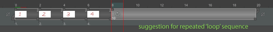

I suggest a better visual representation to indicate that the previous sequence is repeated (it can be in a new frame exposure with maybe slight colour change of the repeated frames, or an icon within the repeated frames) please see some suggestions here
for loop

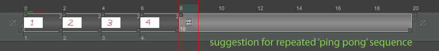

for pingpong
repeat suggestion 'pingpong'

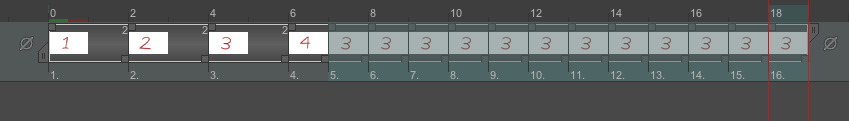

in addition, at the moment if you break the instance of a repeated exposure it results on new frames of only the first image of the repeated sequence, like this:
current bake
current bake
the ability to bake the repetition would be great too! don't you think?

habashtvpaint wrote:the ability to bake the repetition would be great too! don't you think?
This is actually possible. You have to do the following: Start at the end of the repeat and just make a small dot with the eraser somewhere to break the instance. Select the rest of the repeat and hit enter. (Auto-break should be on for this)
