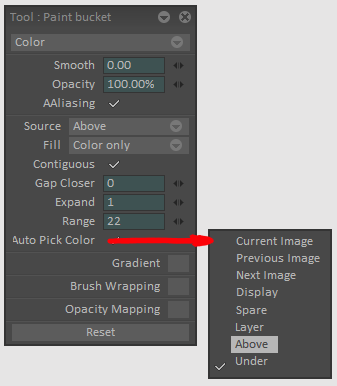

Actually, you would like to get the Auto Pick depending on Source in Shape Settings ?

Elodie wrote:Actually, you would like to get the Auto Pick depending on Source in Shape Settings ?
yes those options sound like a good idea, something like this maybe:
