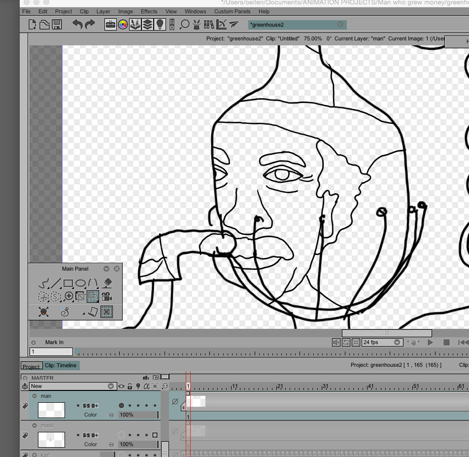

I'm trying to use the mask function and I'm having a problem.
I have a drawing of a bottle on the top layer.
Then I made an inverted mask on another layer that would block out everything outside the bottle.
Then I drew a picture of a face and put it on the layer above the mask.
Everything seemed to work fine, except I can only manipulate the part of the man in the bottle.
I'd like to be able to move him around within the bottle and have other parts of his face (which are currently masked out) show up from time to time.
If I turn the stencil setting off in the main panel, I'm able to move him around say to the right, but the original masked portion of his face doesn't show up. Also when I turn the stencil back on he is no longer contained in the bottle after moving him.
I just realized the mask has completely erased the other part of the man's face.
Is it possible to mask an area without erasing the artwork permanently, move the artwork, have masked areas show up and keep the artwork contained within the mask?

Unfortunately we don't have something like a clipping mask similar to Photoshop. Some people have asked for it and maybe it will come in the future.
At this point you have to deactivate the stencil, animate the face sticking out of the bottle and then activate the stencil, select the frames of the face and erase the lines outside of the bottle.
It is not really a mask in TVPaint. It is more a stencil mode.

ok. Thanks. Glad clipping is on the request list.
