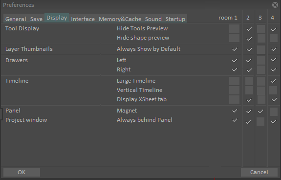

i had previously suggested this solution for the preferences:
a similar solution could maybe be thought off for the keyboard shortcuts?
maybe something like tabs over the left column of the Keyboard shortcut panel
where the tabs would be [All] [room1][room2][room3][room4]
depending on the choice of tab(s) shortcuts are assigned only to the selected tab(s)
