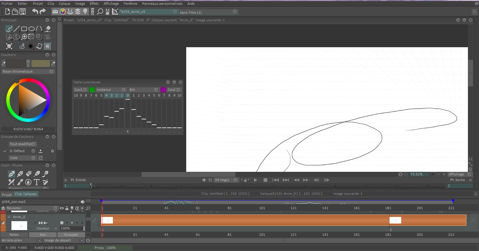

Could you please send a screenshot including whole TVPaint interface ?
Ceres
Posts: 7
Joined: 03 Nov 2015, 21:25
Re: Brush problem after using selection tool
Post by Ceres »
Hi,
Thank you for your quick answer!
A stencil (mask or selection) is enable. Disable it by clicking on this icon :
