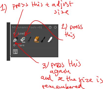

I would also liked this. This is why I scripted my own "Dynamic tools" in 2009.
I shared the idea as the part "tools" of my "Mads Juul Panel" I shared it here http://forum.tvpaint.com/viewtopic.php?f=11&t=3648
Since I have modified it to also contain Layer Preserve Transparency and active paper. And it can also give the paper a random angle each time the tool is loaded.
I attach the panel here.
But it is merely a proof of concept. Because my panel will save/load the tools wrongly if not all the tools used is loaded through the panel(which is how I work)
Becuse(if I should get a little technical) My scripts need to know which tool was loaded the last to work properly. So every tool need a george command something like
Code: Select all
 tv_writeUserString 'tool' 'current' 1
or
Code: Select all
 "tv_writeUserString 'tool' 'current' cut_brush"
or something.
Anyways here is my panel. and you can try it out . try this:
dynamic tools.JPG (30.08 KiB) Viewed 20380 times
But because it doesn't work "Out of the box" is the reason why I havn't shared it properly
MJ Dynamic Tools v01.tvpx
(580 KiB) Downloaded 1100 times

Super nice, thank you!
EDIT : I'm sorry, but your panel does remember the size right? Like actual buttons. What i want is to change the tool but to keep the same size.
Anyway your panel is awesome. We just need to set the size one time and it's good for as long as we need this size for this tool, it's better than what i was expecting in fact.

NathanOtano wrote:Super nice, thank you!
Anyway your panel is awesome. We just need to set the size one time and it's good for as long as we need this size, it's better than what i was expecting in fact.
so sorry. I misunderstood you. My panel does something else. It remembers if you change the size of a custom tool. So I just realize it has nothing to do with your request :oops:
