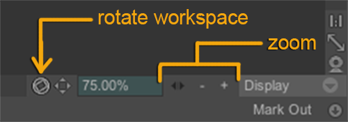

Hi, can someone tell me how to set up my Cintiq 24HD so I can Rotate and Zoom on TV Paint?
Also, I would like to know were I go to change the settings on TV Paint so I can change the look as far as the colors on the buttons. Thanks!
Re: TVPaint Animation 11 : ask all your questions here !
Wayne Carlisi wrote:Hi, can someone tell me how to set up my Cintiq 24HD so I can Rotate and Zoom on TV Paint?
Hi, Wayne (ol' Baer Animation buddy ol' pal ... good to see you here).
Rotate the workspace in TVPaint is this little button at the bottom edge of the project window that looks like an animation disc ; zoom is right next to it (the slider arrows next to percentage and also the little - and + buttons ). Click and drag on the animation disc button to rotate.
Rotate and zoom TVPaint.png (27.46 KiB) Viewed 33869 times
OR you can use keyboard shortcuts to Rotate and Zoom : Rotate Counter Clockwise = Shift Page Up , Rotate Clockwise = Shift Page Down , Reset Rotation to center = Shift Home . Zoom keyboard shortcuts : Zoom out = < , Zoom in = > . These keyboard shortcuts can be programmed to the Express Keys or Touchstrip on your Cintiq . I don't have a Cintiq 24" HD , but I have the Cintiq 21" and I think the set up of the Express Keys and Touchstrip is similar to this : https://www.youtube.com/watch?v=8yktk05Gr8I" onclick="window.open(this.href);return false;
