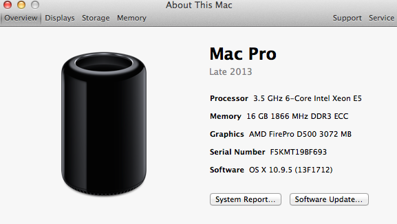

Joanna, having the specs of your Mac would be helpful : what processor do you have, how much power does it have, which amount of RAM .. ?
To do so, click on the Apple button on the top left of the main bar, and click on "About This Mac" : A window will appear, looking like this : With all the specs
Re: Playback not accurate
Thanks everybody for all your suggestions. I have checked all the boxes in the preview panel as suggested and it appears to be playing all the frames but as predicted it is playing back in slower time.
What do my specs below tell you?
Thank you
Joanna
Thank you
Joanna
- macpro info.png (72.22 KiB) Viewed 35389 times

Your Mac Pro seems ok to me.
