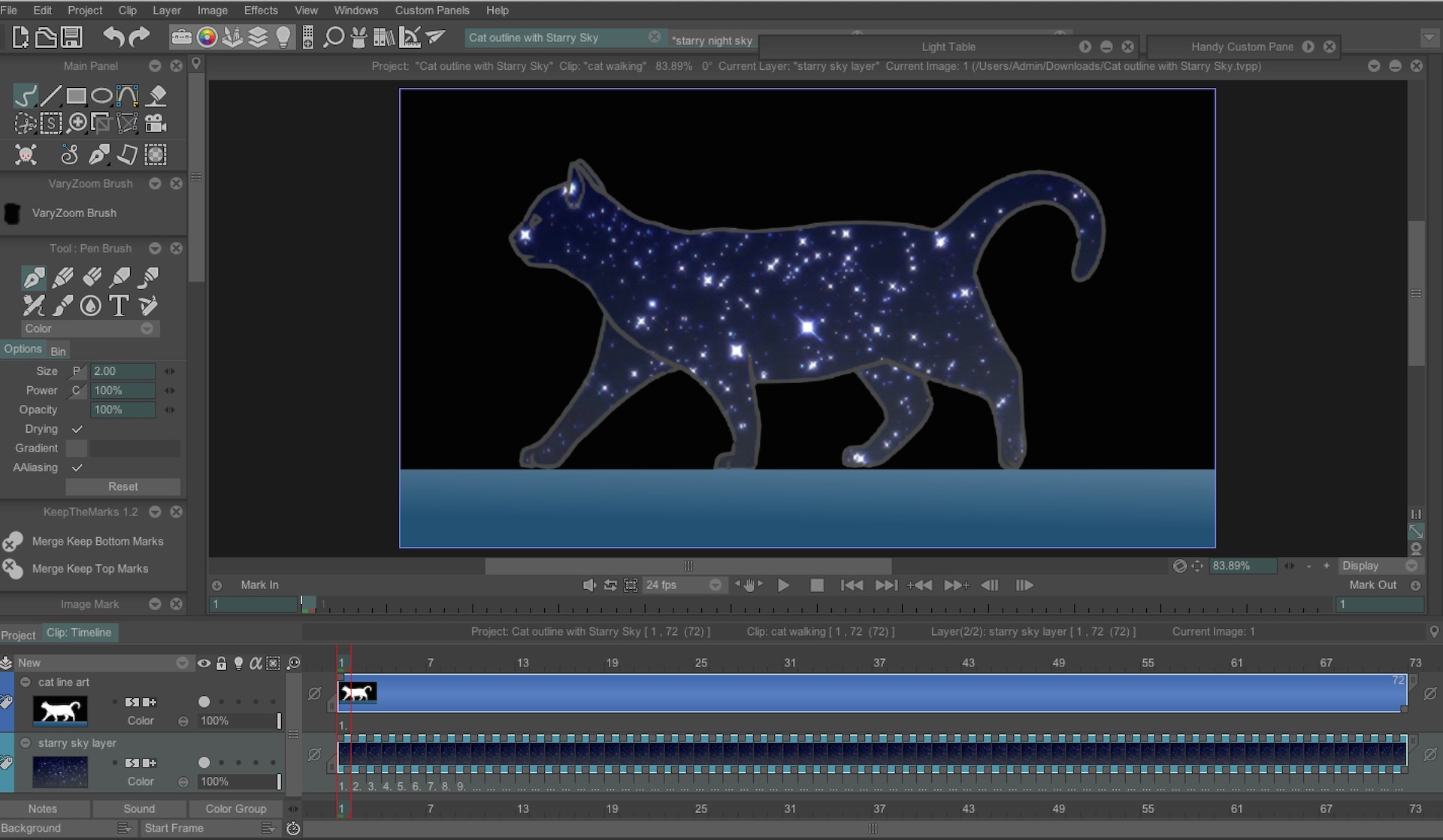

Here is how I would duplicate the look of "Day & Night" that you referenced:
The cat layer is line art. Fill it with BLACK in the area around the cat (so the cat interior is clear).
Have your starry night background on a layer underneath the cat line art. (this background could also be a separate project , referenced as Source layer in the KeyFramer FX tool in the FX Stack)
(click image to see it larger)

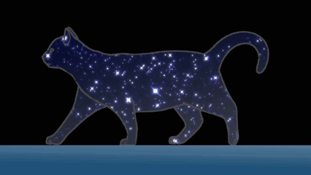

EDIT: Elodie mentioned the gif image above is not showing . If it's not showing up for you I'm attaching the gif file below. (you will have to click on it or download it to view) .

Re: Please help with my cat animation FX
David, I cannot see the 2nd image :)
Elodie wrote:David, I cannot see the 2nd image :)
Does it show now ? It's on my Google Photos . I adjusted the sharing permission of the image , so it should be public now. (I hate the new Google Photos ... I miss my Picasa Web Albums ... Google Photos makes it difficult to know if images are "shared" or not ...)
Much better, thank you :)

Hi, thank you for replying! But Im afraid that's not really what I want to do. I cannot have the black BG around the cat, as the cat will walk on the scrolling jungle background with other animals. Basically the cat is the only one which needs to have the starry sky in her. I guess it will act as sort of a mask, but I do not know how to make it work properly.
I hope this makes more sense, as Im pretty bad at explaining technical things lol
