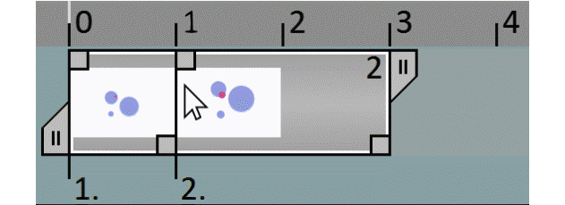

: What do you mean by sprocket in TVP?
Re: Shortcut on sprocket
Like a film perforation, I guess.
Click the image to see a quick animation I made for my students. I deleted some noisy aspects of the interface for the sake of simple demonstration.
