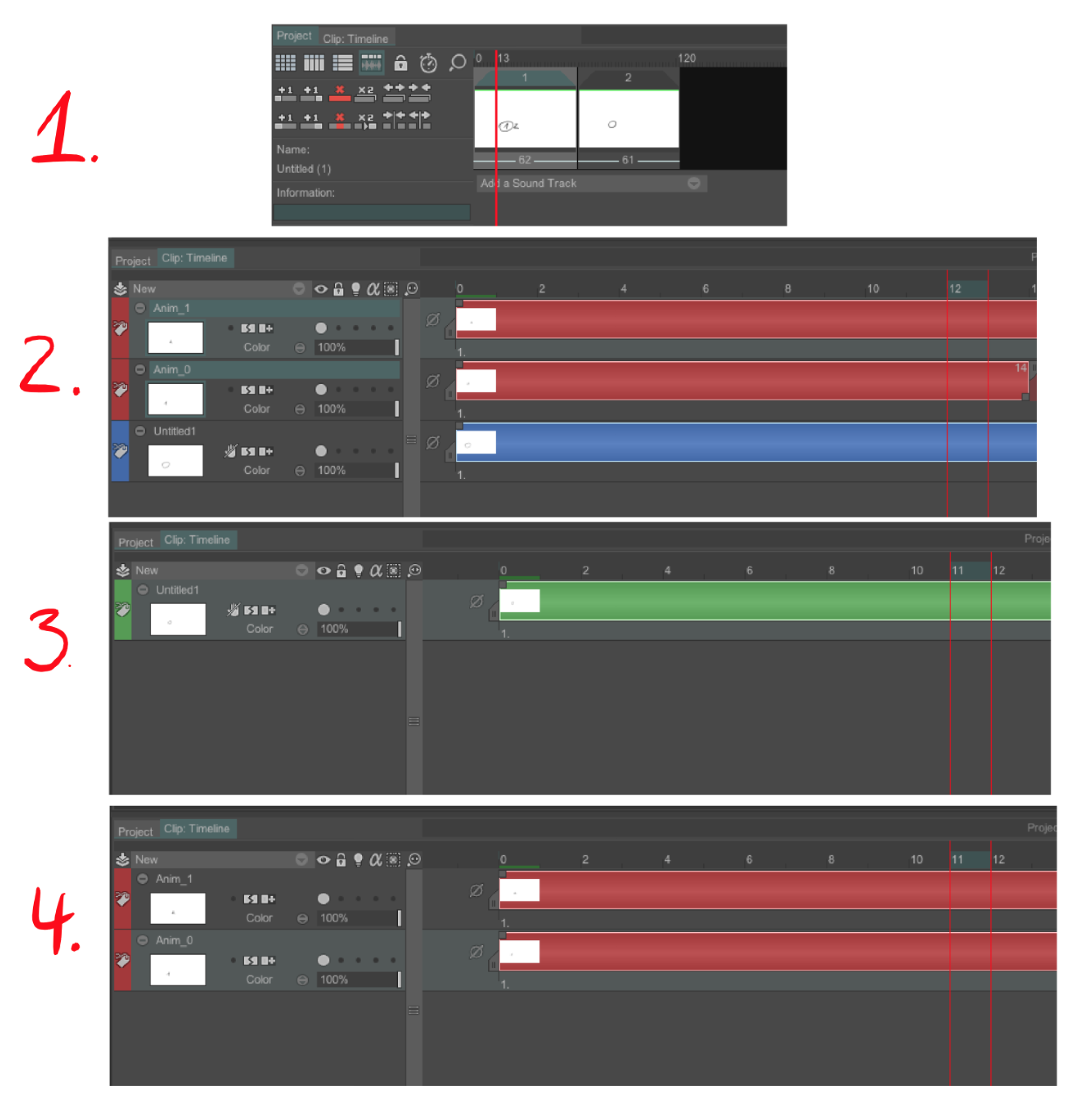

There is a misunderstanding.
You have to create a project with two scenes in the project tab (see screenshot, first point).
I can also record a video later to show better what I mean.

Here is a video that makes it more clear, hopefully:
If you only copy one layer, you have to select the layer so that it is blue, then the problem also occurs.
I understand that when a layer is selected blue it gets overwritten by the layers you paste. When you go to another scene though, no layer is selected blue and gets overwritten anyway because other layers in a different scene are still selected blue.
It is just strange that two different scenes don't get fully separated by the program.
You have to copy two layers to see the problem. If you only copy one layer, you have to select the layer so that it is blue, then the problem also occurs.

Re: copy& paste strange behavior, possibly bug
I think I found the "problem".
You have to use the timeline view in the project tab. Don't double-click on the thumbnail but use the "Clip: Timeline" tab.
When you use double-click to enter a scene, you automatically deselect the layers. In timeline view you can scrub through and click on the "Clip: Timeline" tab. This way the layers remain selected.
Also related to this, still in timeline view:
When you mark some frames and go to a different scene, the frames are still marked.
See this video (again don't double-click on the thumbnail but use the "Clip: Timeline" tab): The whole topic may sound silly now but I never used double-click to enter a scene. It is just my feedback on the behavior at this point.

Re: Pasting a layer thing
Please see here : viewtopic.php?f=10&t=10384" onclick="window.open(this.href);return false;
The solution is also described there.
It is a little bit difficult to explain but make sure that the layer name is not marked blue before you paste your layer. You can go one frame left or right before your paste to avoid the problem.
