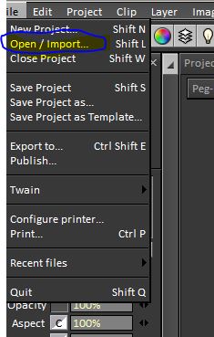

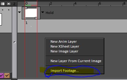

I was wondering if there is a limitiatons on wich video format that can be importet into TvPaint. 10 pro?
I´m trying to import some video footage from a sony experia compact telephone. But with no luck?
I have tried two way that I know of.
1: File / Open/Import...
2: In the timeline-Right click /Import footage.
Non of theses ways work.

TVP exports .mov, .mp4 and .avi files on my Mac. If it plays in the native player of your operating system, it should import as well. If not, I have to convert it first.
