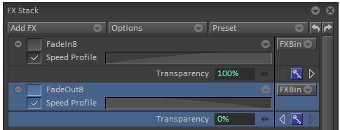

Hi Dave, When I download it here, it seem to load ok??? I'll upload another zip version just to be sure.D.T. Nethery wrote:When I try to import the Fadein-FadeOut.bin it says "Bad or Corrupted Bin File".
Meanwhile, you can set it up yourself very simply. Below is what it looks like:
Under MultipleFX I loaded Fade effect from the Transition group, renamed it FadeOut8 then loaded in Fade effect a second time and renamed it FadeIn8.
Then with FadeIn8 selected, I set a key at 1 to be Transparency 100% and a key at 8 to be Transparency 0.
Finally I unselected FadeIn8 and selected FadeOut8 I set a key at 1 to be Transparency 0% and a key at 8 to be Transparency 100%.
After testing, I saved the effect as FadeIn-FadeOut.bin

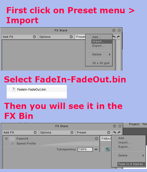

Exact response here, wonder if there's a solutionD.T. Nethery wrote: ↑14 Feb 2017, 16:38Hi, Sven -Svengali wrote:Here's my universal FadeIn-FadeOut.bin file. To use it, simply load it in FX Stack / Multiple FX and check either of the two effects: FadeIn8 or FadeOut8. The default size is 8 frames, but either can be positioned and stretched to any frame count. The Speed Profile curve can be adjusted to weight the rate of fade.
Sven
Re: Fade in affect?
I found the problem: I was trying to import Sven's fade preset into the FX Bin for Transition > Fade . But it needs to be imported through the Presets menu . After importing FadeIn-FadeOut.bin to the Presets , it will be in the FX Bin after that.cyrus rebello wrote: ↑17 Feb 2017, 14:23Exact response here, wonder if there's a solutionD.T. Nethery wrote: ↑14 Feb 2017, 16:38Hi, Sven -Svengali wrote:Here's my universal FadeIn-FadeOut.bin file. To use it, simply load it in FX Stack / Multiple FX and check either of the two effects: FadeIn8 or FadeOut8. The default size is 8 frames, but either can be positioned and stretched to any frame count. The Speed Profile curve can be adjusted to weight the rate of fade.
