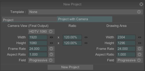

If you're going to zoom in very close on the artwork (say, going from equivalent of a "12 Field" to a "4 Field" in traditional animation terms, if you know what I mean) you would want to work at two - to - three times the resolution of the intended output. (moving in as close as equivalent to "5 field" or "4 field" , I'd be safe and work at 3x the intended output resolution)
So for 1920 x 1080 , if you set the overscale for 120% , your project size would be 2304 x 1296 , which would still give you a little bit of wiggle room if you needed to adjust the framing on the artwork.

For scenes with no camera movement you would be fine to work at the intended output resolution of 1920 x 1080 . However , even with no camera movement , you may want to overscale it a bit ... in TVPaint Pro you can create a New Project With Camera View , which allows you to set the amount of overscale ... 120% - 150% - 200% - whatever it may be. As a general rule I will work 150% - 200% over the intended final resolution , so if I have to do any transforming (rotating /scalings images) or camera moves, the line quality will be sharp when it is exported to the final resolution.-- For scenes that don't have camera moves is it best to use the full drawing area (3840 x2160) or the size of the camera view (1920 x 1080)?

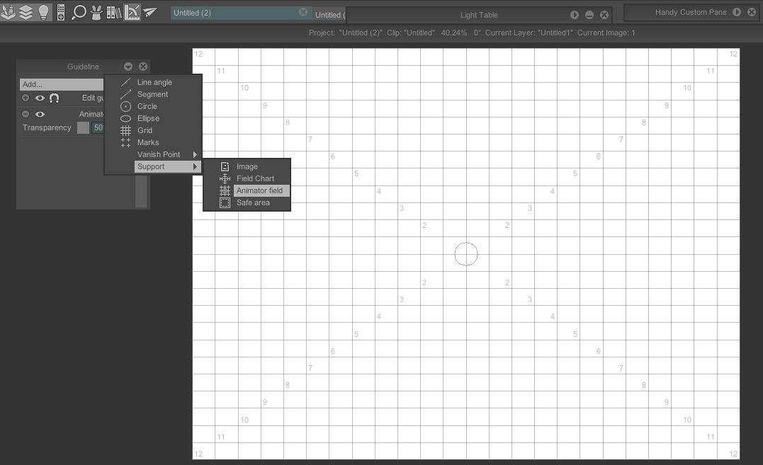

TVPaint actually does have a standard 12 Field overlay in the Guidelines Panel , for those who still use such things.

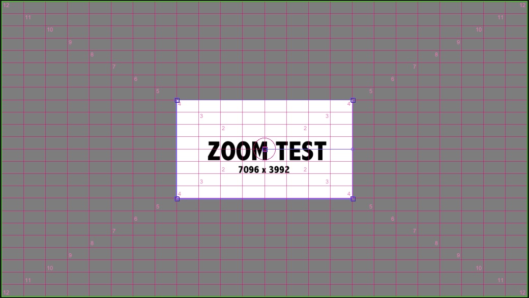

Re: Questions about Photoshop backgrounds

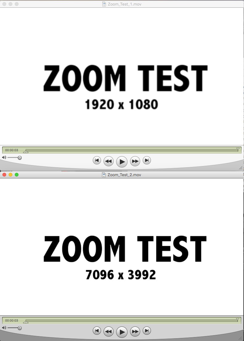

Yes, that's a good way to calculate the size of your artwork for a camera zoom. You can see it in these two examples:
Example 1 - original size of project 1920 x 1080 , zoom-in from equivalent "12 Field" to equivalent "4 Field" . Output to 1920 x 1080.
You can see the image go soft as the camera zooms in closer.

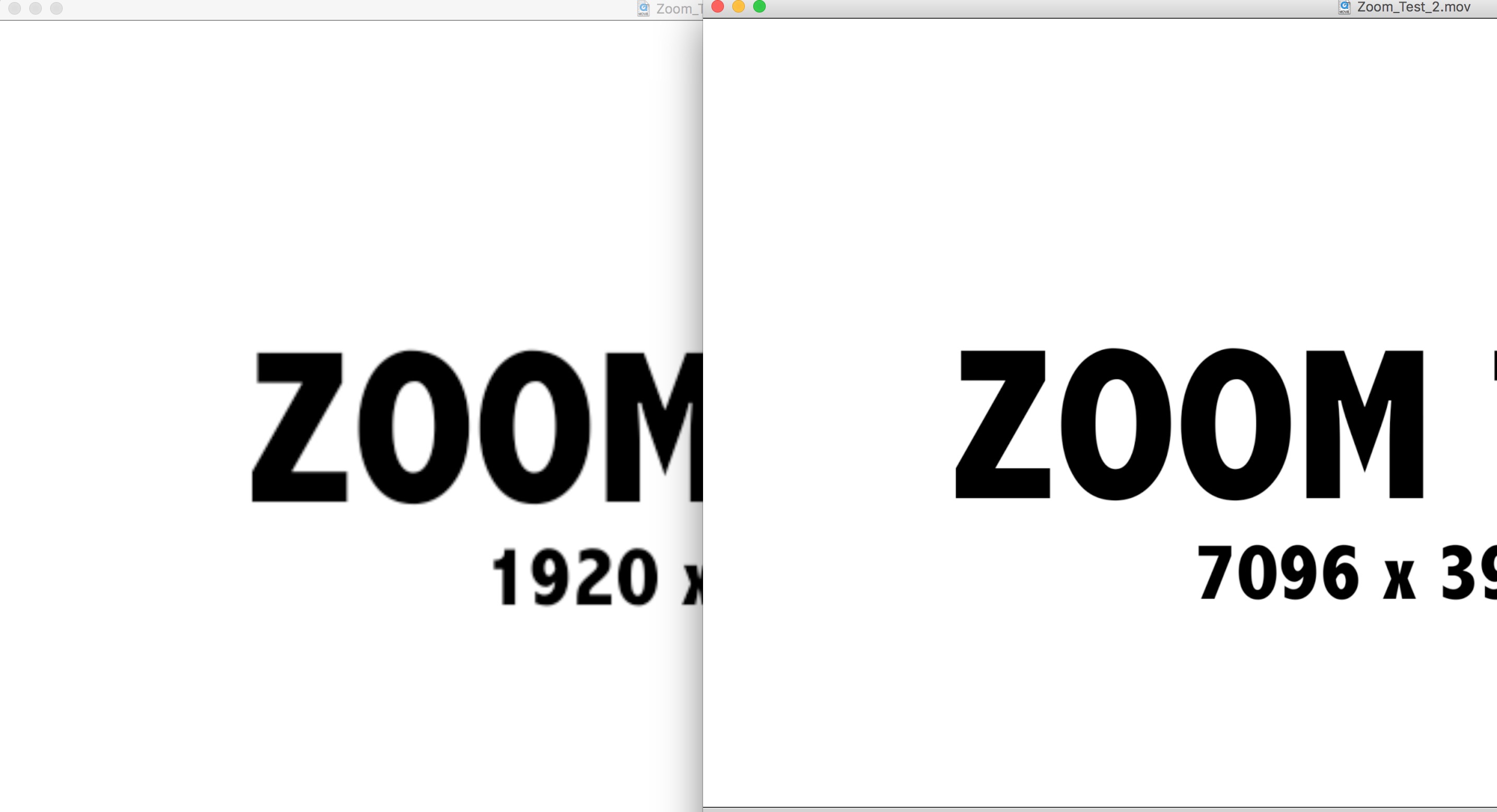

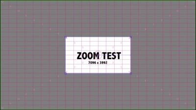

Example 2 - original size of project is 7096 x 2034 (almost 4x intended output of 1920 x 1080.)
Both end up the same output size (1920 x 1080) , and at the start both are equally sharp, however
Example 2 with the higher definition retains the image sharpness over the entire duration of the zoom-in.
(click on embedded images to see them larger)
The difference in image sharpness is more apparent on the two attached movie files viewed full size on your monitor:

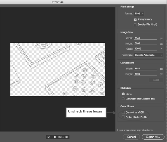

I think I just discovered another solution to avoiding an ICC error -- Photoshop CC 2017 allows you to export a PNG without the profile and without converting it to sRGB. When you use "Export As," the files settings allow you to uncheck both the Convert to sRGB and Embed Color Profile boxes.
