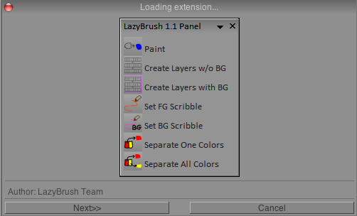

A Note to the Toolbar
Shoudn't it install automatically with the installer?
-Mads
I have installed Lazy-brush 1.1 on Windows 64bit but the TVPX panel did not show up so I searched manually on my Computer and found the Panel in Wondows Temp folder and installed it.lazybrush wrote: [2] A new TVPaint toolbar has been added with icons which allows hotkey assignment.
-Mads
Re: Revolution in coloring lineart: LazyBrush plugin release
Dear Mads,madsjuul wrote: I have installed Lazy-brush 1.1 on Windows 64bit but the TVPX panel did not show up so I searched manually on my Computer and found the Panel in Wondows Temp folder and installed it. Shoudn't it install automatically with the installer?
thanks for testing the new version! Yes, TVPX panel should install automatically, however, it seems the installation process does not went through. We think Sandra has a similar problem. The issue here is that we were not able to find your TVPaint executable. We need it since we have to execute TVPaint. In the final release we'll probably remove this automatic installation procedure and distribute the panel separately as an optional part to avoid these issues.

Sorry to say but doesn't work. Lazy brush still works with my old configuration but opens only from custom panel menu. Not from window-> plugin.
When installing with new configuration I get Loading extension.. No place for serial number. Then lazy brush opens normally. When trying to paint it says Lazy brush trial expired and no place for serial number.
M.
M.
- Screen Shot 2013-11-08 at 10.07.52 AM.png (24.03 KiB) Viewed 100577 times
- Screen Shot 2013-11-08 at 10.08.12 AM.png (6.21 KiB) Viewed 100577 times
Mikko Vormala
Re: Revolution in coloring lineart: LazyBrush plugin V1.1 !
Well that's really wierd, I don't have any explanation why the LazyBrush window is not showing up now after clicking on Windows->Plugins->LazyBrush.elmisilhumano wrote:Lazy brush still works with my old configuration but opens only from custom panel menu. Not from window-> plugin.
Anyway, I prepared yet another version where the Unlock button is in the "trial expired" window (see the screenshot). Hopefully this will fix it for you.
The updated packages are again here:
Mac: http://lazy-brush.com/dl/LazyBrush-1.1.dmg
Windows: http://lazy-brush.com/dl/LazyBrush-1.1.zip
Thank you for your cooperation, and sorry for the inconvenience.
- screenshot.png (3.47 KiB) Viewed 100566 times
- elmisilhumano
- Posts: 1110
- Joined: 28 Aug 2006, 20:41
- Location: Finland
No idea why it doesn't work like it should but now it works with latest update. Thank You.
