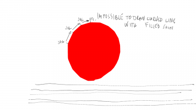

The problem is visible when using the dotted line test, but even worse problem becomes apparent when I use the filled stroke tool. As for now I am not able to make curved shape with filled stroke, which makes my software unusable. Can you please give me advise and tell me what are my options? I have a deadline. Thnx.

I am an idiot. I am sorry. But Mac has this annoying thing called Open in Low Resolution, but every time you update the software, this has to be ticked again (and I knew that, because that is also happening with Houdini which I update regularly). Obviously I forgot, now it flies like the Elon Musk shuttle. And, yes, my version is updated to 11.0.6, so that was the cause of the problem :)
