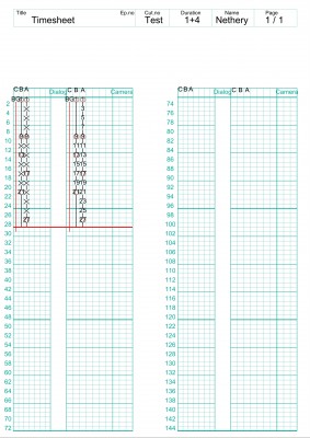

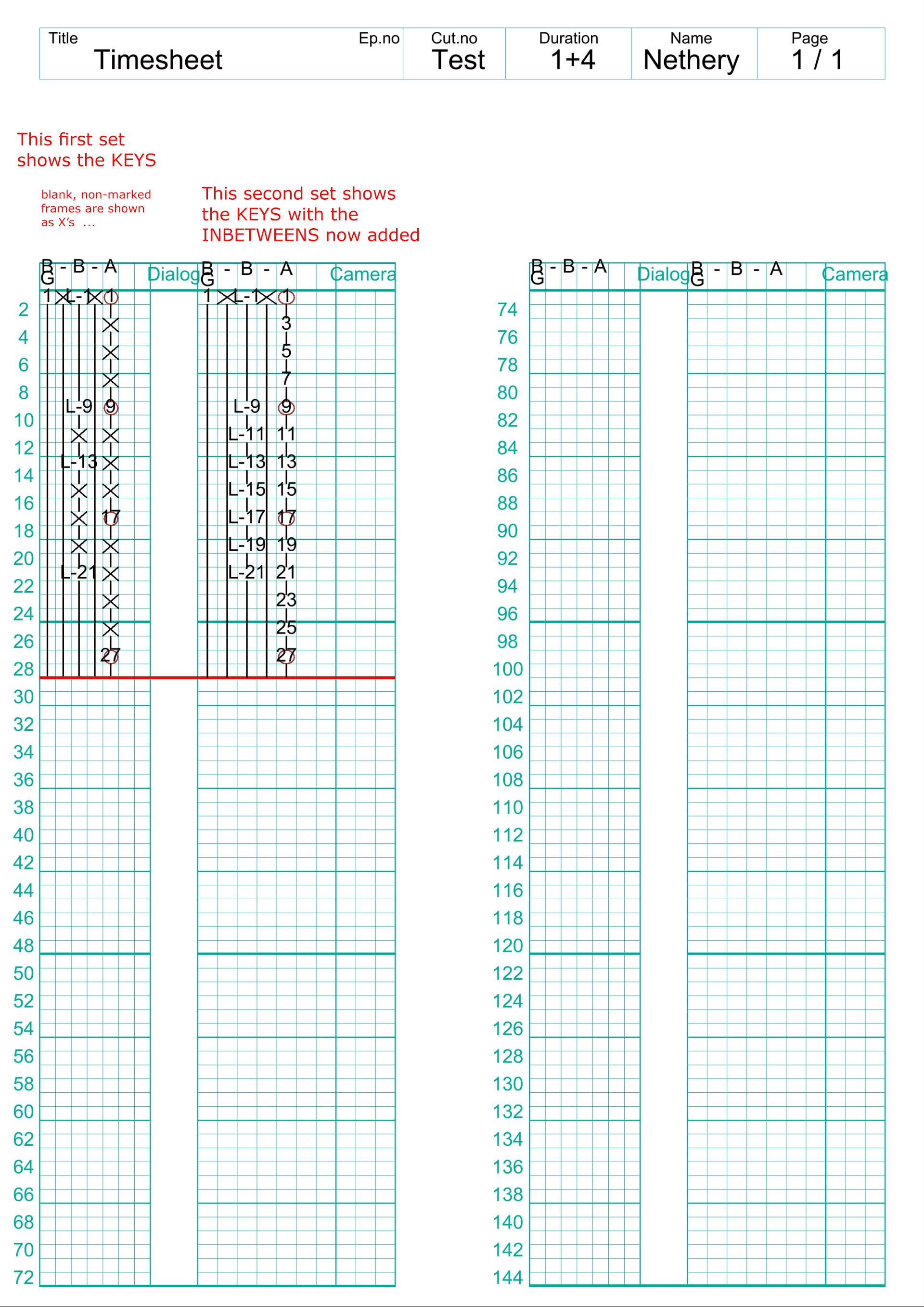

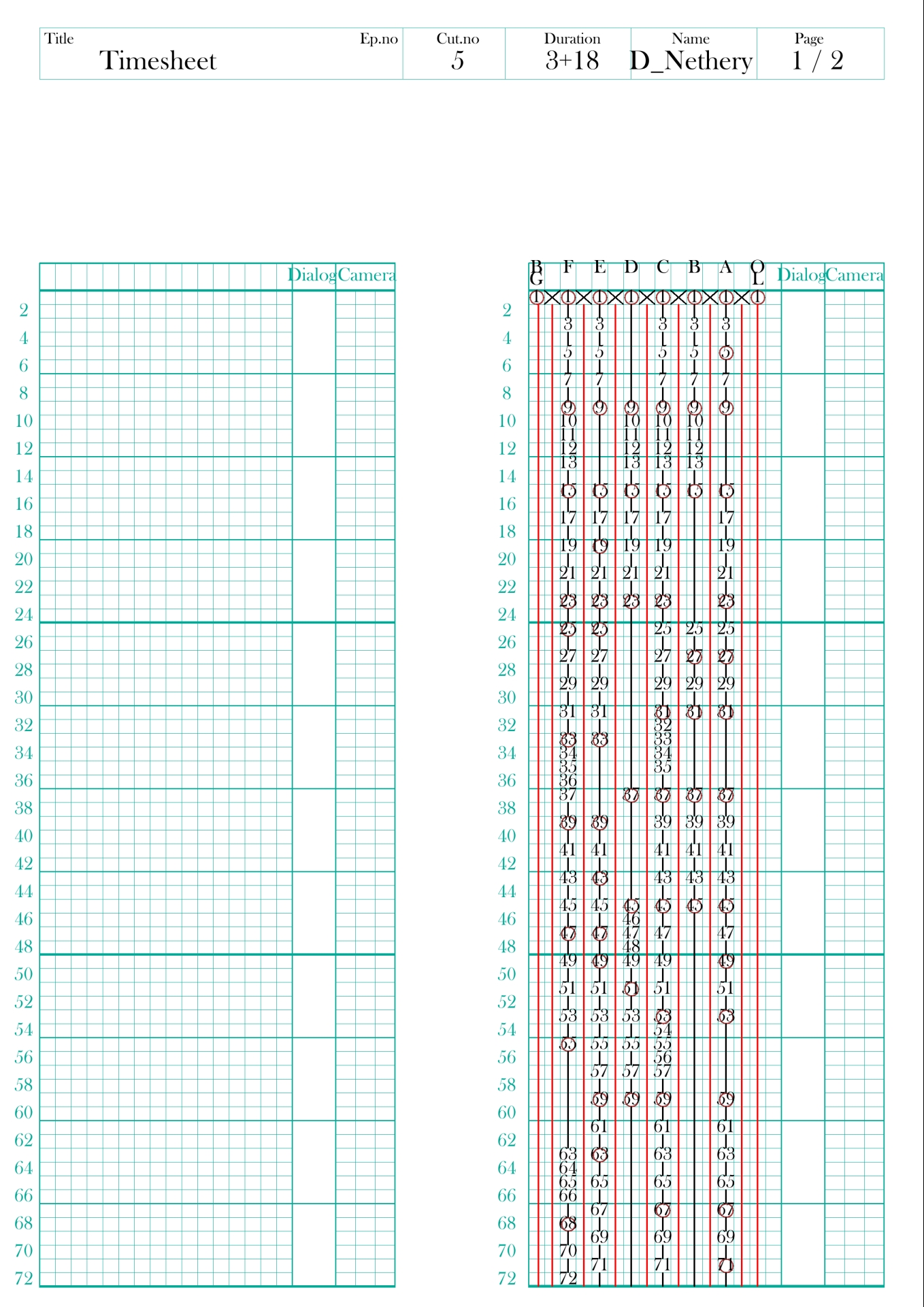

Here's a simple example with only three layers:
Anim - A
Anim- B
BG

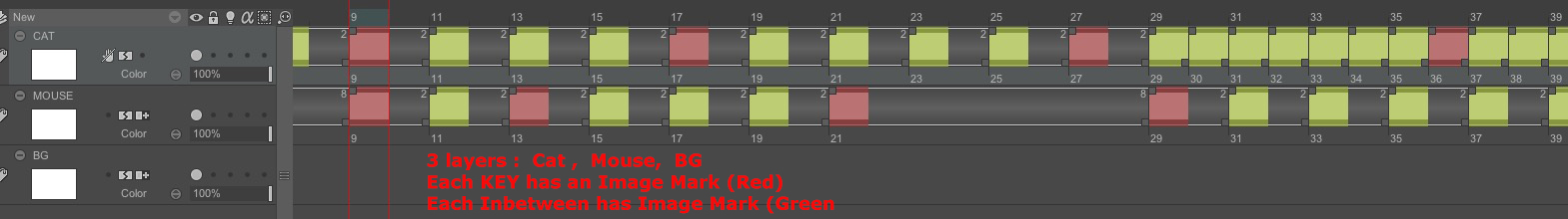

My keys on Anim layer A are 1 , 9, 17, 27 and are given a RED image mark .
My keys on Anim layer B are 1 , 9, 13, 21 and given a BLUE image mark.
(although notice there are actually 5 layers in the layer stack : I added two blank layers with no name as "spacers" between layer A and layer B and between layer B and the BG layer
so it wouldn't be quite a cramped when rendered to the sheet . That sort of worked, but sort of didn't , it still looks cramped to me.)

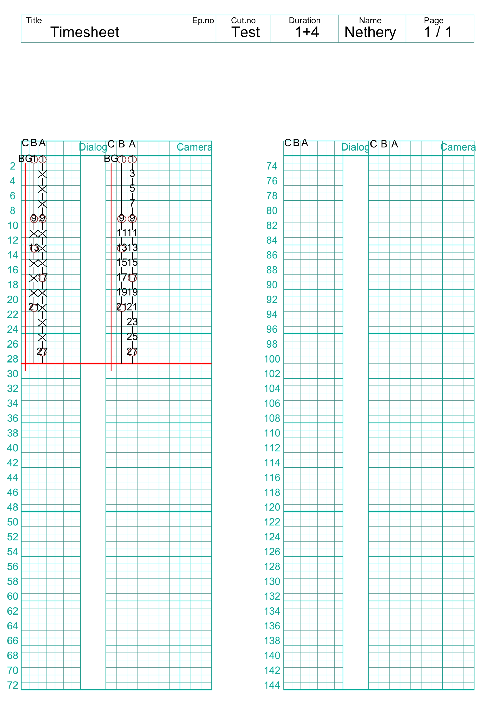

Click on the button in the Timesheet panel that says Timesheet Key and it generates a sheet showing the keys only , with missing
inbetween frames as X's .
inbetweens will be filled in and image marked in the next step.
Now let's say I have gone back in and added the inbetween frames on Anim layer A - 3, 5, 7 , 11, 13, 15 , 19, 21, 23, 25
and inbetween frames on Anim layer B - 11, 15, 17, 19 (1 is held for 8 frames , 21 is held for 8 frames on layer B)
Image Mark colors assigned to the inbetween frames.
Then click on the button in the Timesheet panel that says Timesheet Inbetweens and it redraws the sheet to add a new set of
columns to the right of the first set , showing the inbetween frames which have been added .
[click to see it larger]

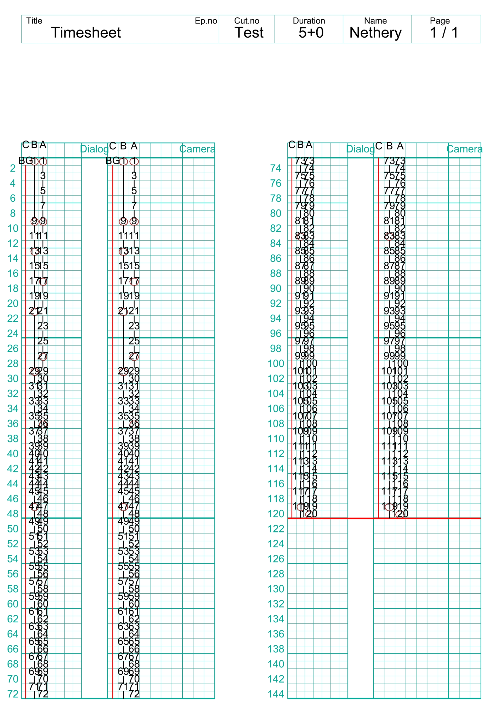

So this is now behaving more like I would expect from an "X-sheet" ... BUT some issues remain for me, namely the spacing is too cramped. The font sizes used for the layer names, the drawing numbers , the "Dialog" and "Camera" columns all render too large for the space they are intended to be contained in , so readability is an issue. The red circle placed around the drawings designated as KEYS is a good idea, but the circle is too small compared to the font size used. Perhaps this is an issue on my end , my default fonts are set too large or something ? I don't know . Again, I'd be curious to see how this works for someone else . I feel confused when trying to use this tool. Really, in my professional experience, there's nothing more logical and elegant than an X-sheet . It should be clearly legible . This tool is a step in the right direction, I can see it being useful, but it still needs refinement in my opinion. (or else I need a swift kick in the pants and someone to tell me what I'm doing wrong when I try to use it , if this confusion is just me being an idiot) .
It seems to work better if you do NOT give the instance name's a Prefix letter(s). Not quite so cramped-
In this case with the single Background image did I name the instance as "BG" , so it would show up clearly on the sheet . The layers are simply named A - B - C (the BG is on layer C).
Of course the way this currently works the TVPaint timesheet has rendered the layer ordering as : C - B - A , but you just have to do the mental gymnastics to reverse the standard ordering and realize that on this sheet the lowest layer is the first one on the left and the topmost layer is the last one on the right . (to my way of thinking that order should be reversed to read from left-to-right , but this is what is for now ...) .
By the way, this PRINTS nice and easy, from File Menu > Print .
It gets unreadable when you move from two-digit numbers to three-digit numbers. It seems like the font size should adjust automatically to resize itself to fit inside the available space on the timesheet instead of everything getting smooshed together into an unreadable mess. This can't be right ? Someone from TVPaint tell me what I'm doing wrong here

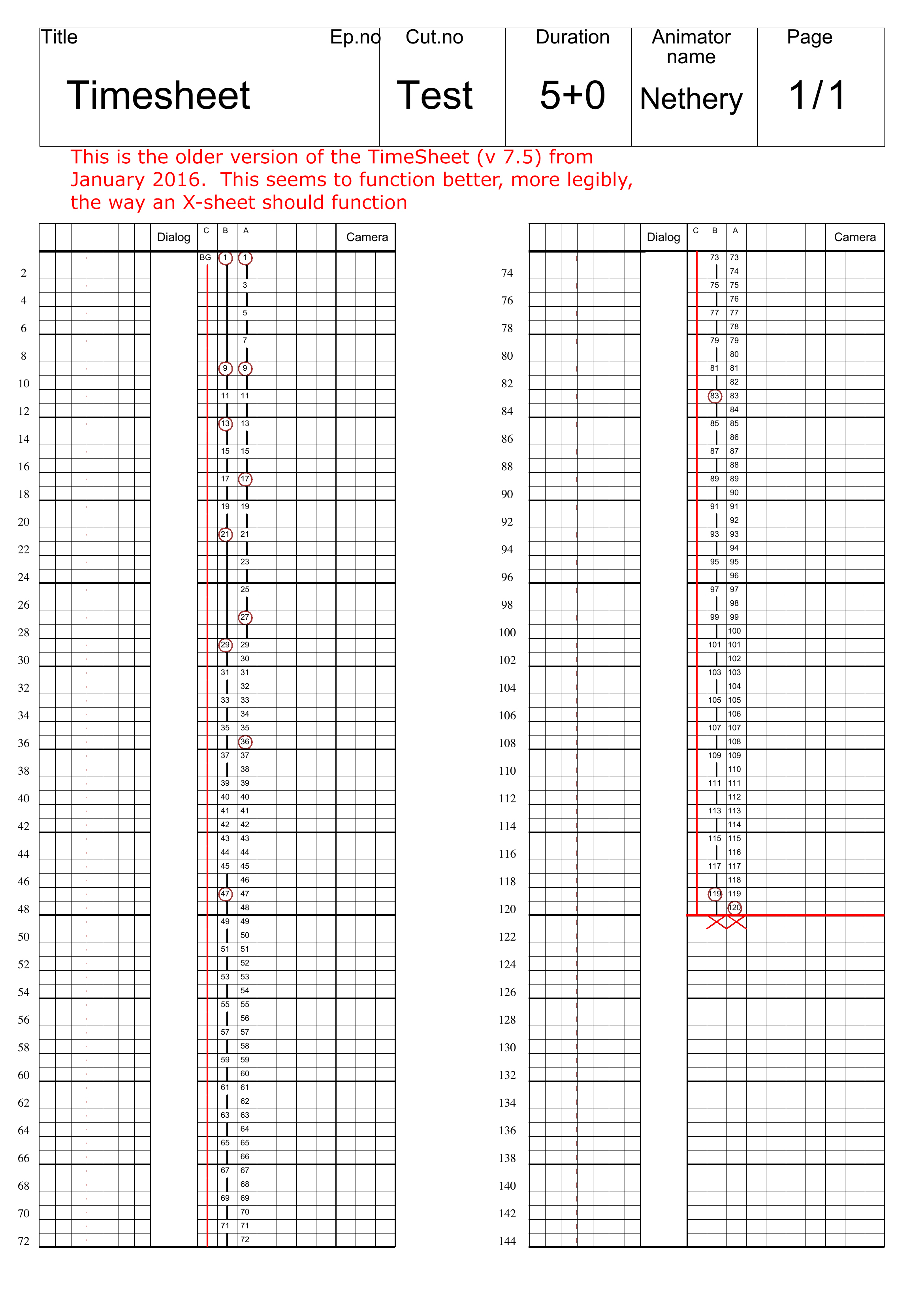

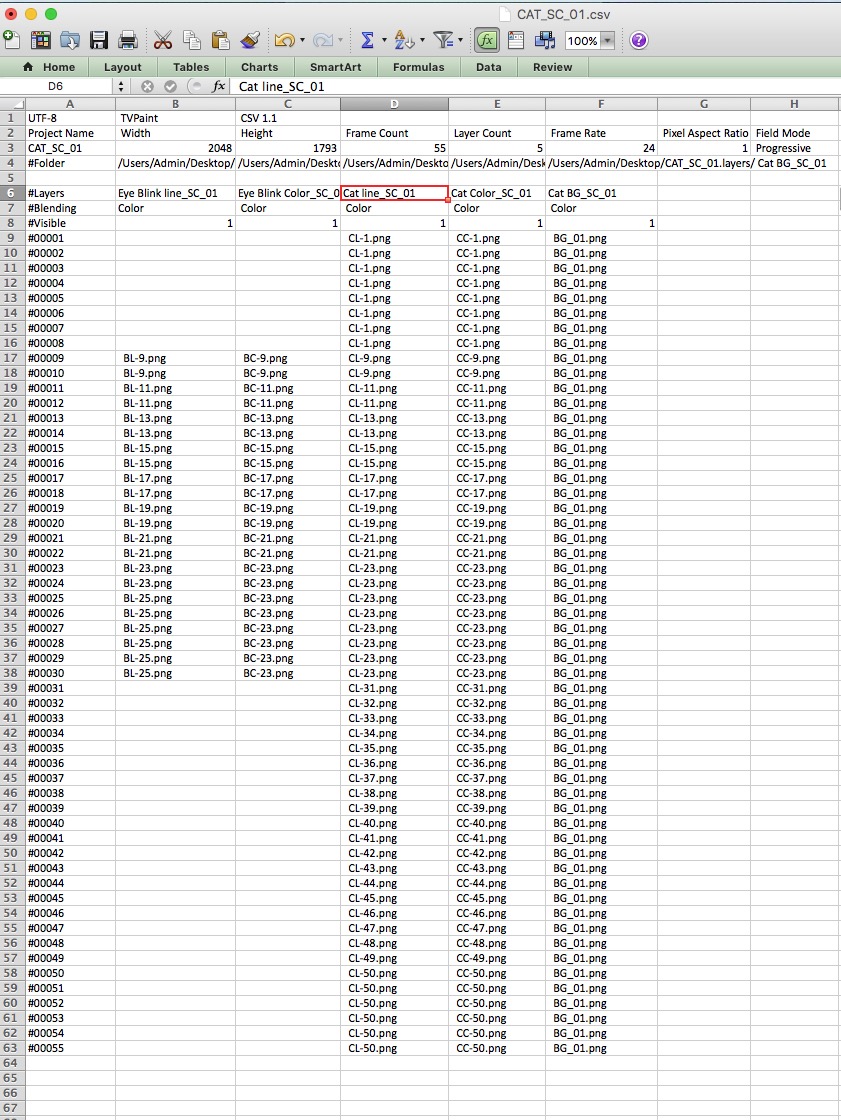

On the current version of the Timesheet , is there any way to adjust the size of the font used , so it isn't so cramped ? What do the Japanese studios do when the numbering in their scenes is in triple and quadruple digits ? The sheet becomes unreadable .
The older version (Time Sheet 7.5) was better in that respect -
About the CSV export :In your case, you may use the CSV export (Clip : layer structure).

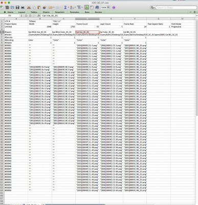

It is also cluttered and difficult to read . Is it possible to refine how the data is imported to the Excel .csv file ?

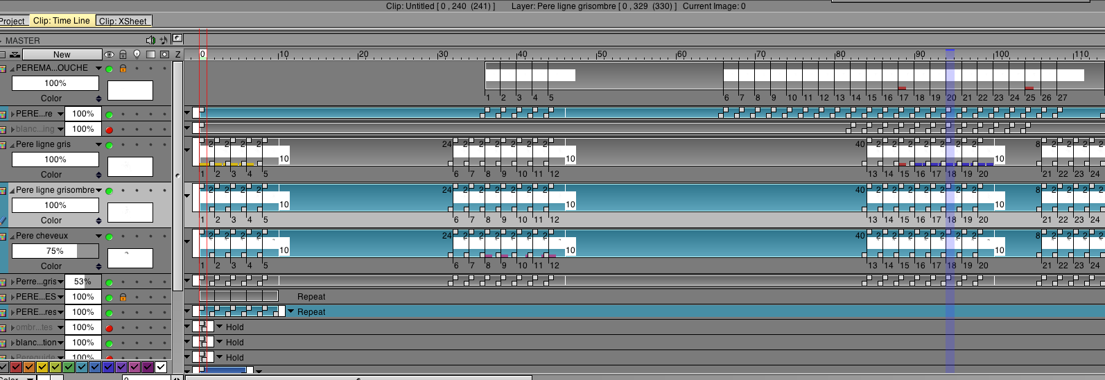

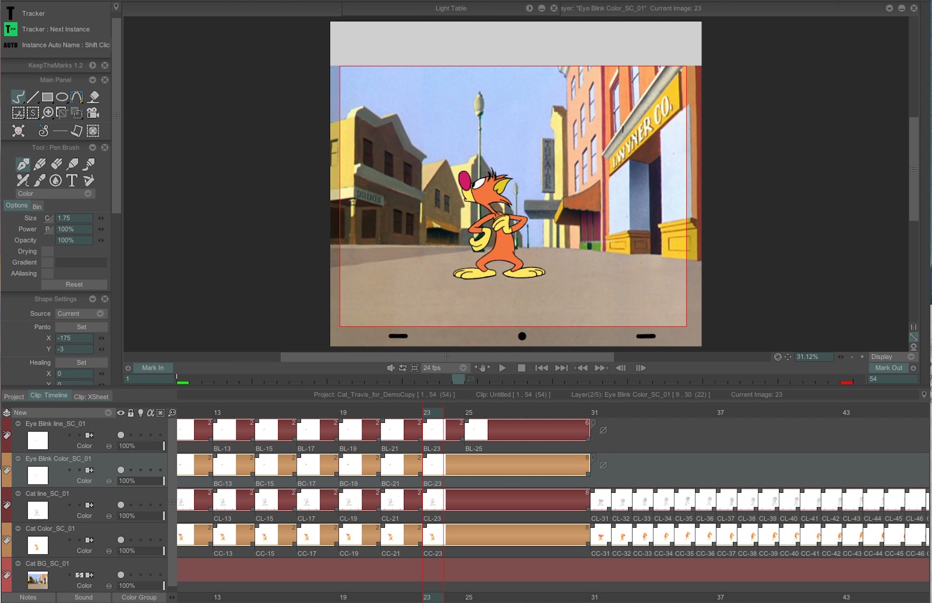

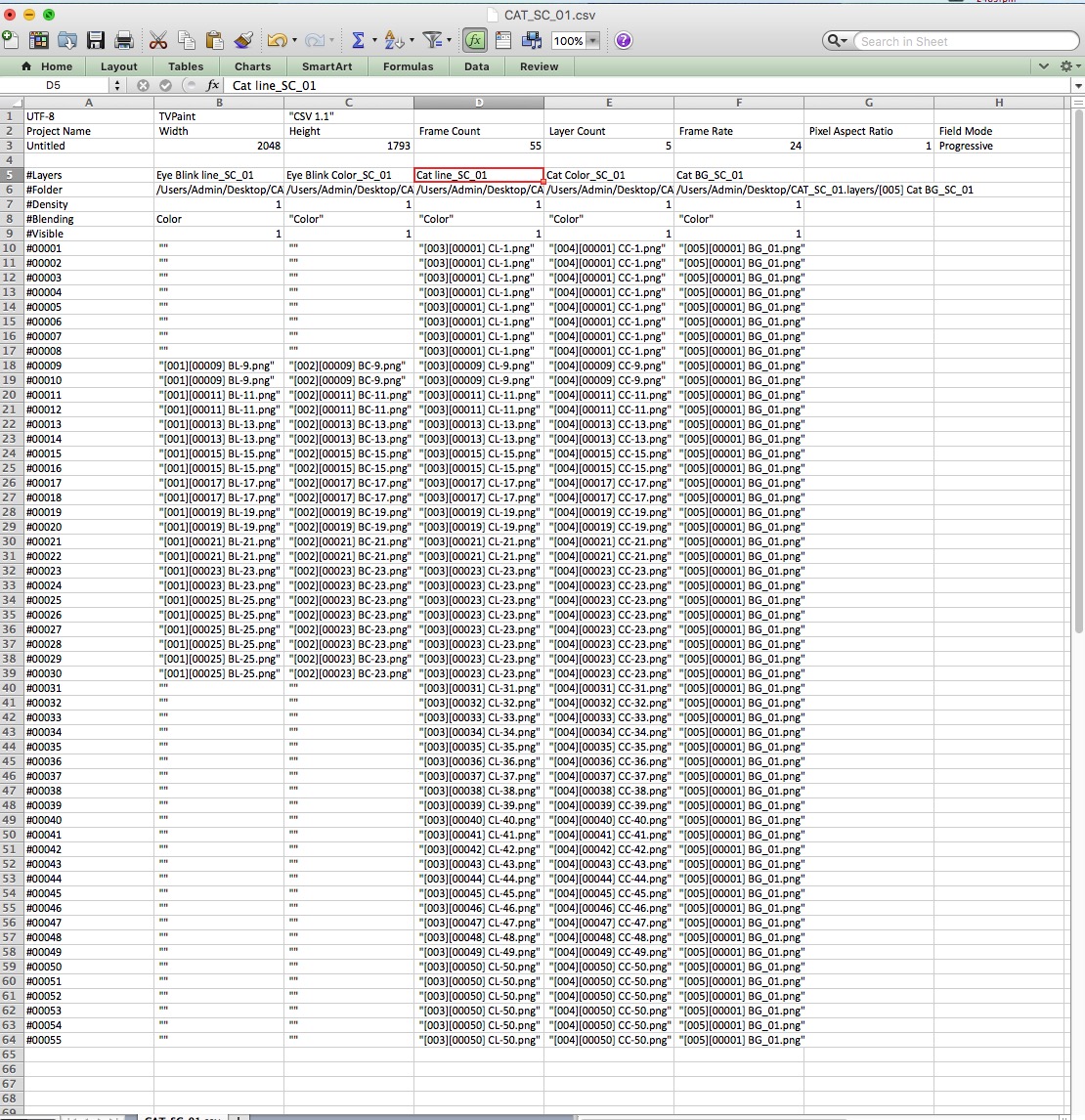

For example , here is a simple scene with 5 layers: 1.) Eye Blink Line , 2.) Eye Blink Color , 3.) Cat Line , 4.) Cat Color , 5.) BG
Using Mads Juul's Tracker Shortcuts panel , I've named each instance with an identifying Prefix and the Numbering corresponding to the frame numbers.

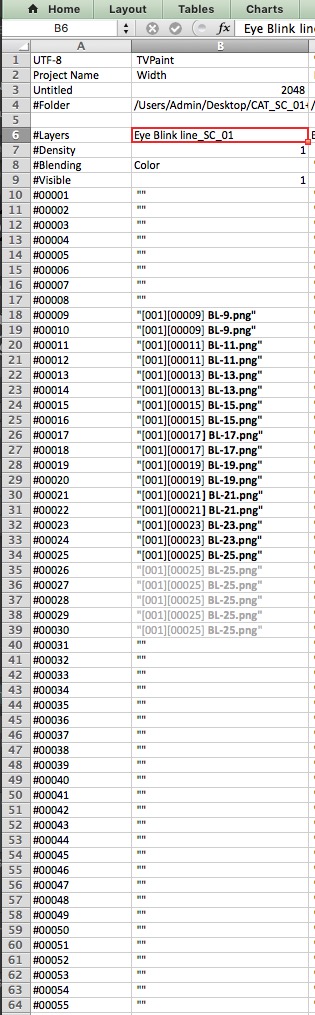

When I export this to .CSV file , many extra bracketed numbers are inserted , creating a somewhat cluttered, unreadable document :
(on this CSV why is Project Name listed as "Untitled" , when the Project clearly did have a name : CAT_SC_01 . I named it and saved it, so I would expect to see
that name where it says Project Name in the upper left column A , Line 3 . Why does it need all the extra numbers in brackets inserted in front of the instance names ? That just makes the sheet very cluttered .)
It would be so much clearer to have the CSV export look something like this :
To my eyes, this is much cleaner and readable , with some resemblance to what we all know as an X-sheet .
The extra bracketed numbers inserted seem redundant to me . The first set of bracketed numbers seem to be the Layer number [001] , then the next set of bracketed numbers is the frame number [00009] ... We already have the frame count along the left in Column A . So why insert the frame number again in front of the instance name in each column ? We can see how many layers there are , so the layer number doesn't need to be inserted in front of the instance name. If those extra bracketed numbers could be eliminated and instead just have the instance name in the columns , it would be cleaner .
However, if it is not possible to eliminate those extra bracketed numbers that are inserted in front of the instance name , can it be configured to show the instance name in BOLD font for better readability ? And even better , can HOLDS be shown in lighter grey font ? See the next screen shot . This shows the column for the the cat's Eye Blink LIne , which occurs from frame 9 to frame 30 , however the eye drawing 25 is HELD 6 frames, so it only appears in BOLD font at the head on frame 25 , then frames 26 , 27, 28, 29, 30 it is in light grey text . This makes it easy to spot the holds at a glance when reading the Excel sheet.
[click image to see it larger]

Well, I've made it so the Timesheet uses a Japanese font which takes less space. I don't know why it's that big on non-japanese versions though... I don't know if I can change that easily without interfering with the "intented" font, but I'll check when I'll have the time.D.T. Nethery wrote: ↑29 Jan 2018, 14:09On the current version of the Timesheet , is there any way to adjust the size of the font used , so it isn't so cramped ? What do the Japanese studios do when the numbering in their scenes is in triple and quadruple digits ? The sheet becomes unreadable .
About the numbers: they represent the instances names: in Japan, they always name their instances with numbers: thus, they never go higher than 2 digits: they split the scene so it doesn't become too long.

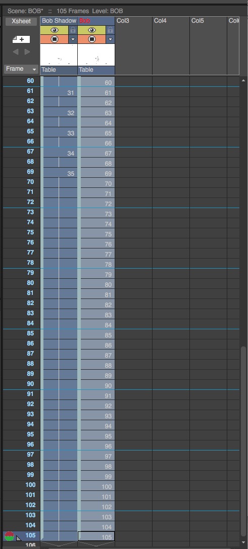

I have all the same questions, D.T. This is what I get when I make an xsheet. There are no numbers at all, only x's and o's. It's totally useless. I see that at least you got numbers, and I don't know how you did it. The older xsheet panel that you shared, which at least has the nicer looking printout. I downloaded it but I don't know how to install it. Any tips? Thanks.
- grab xsheet.png (51.15 KiB) Viewed 34382 times

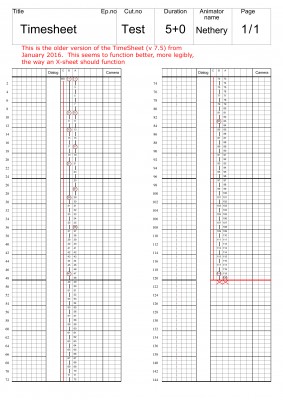

To install the older version, download the file Sheet_7-5.tvpx from this topic:Janet Perlman wrote: ↑29 Jan 2018, 15:27 I have all the same questions, D.T. This is what I get when I make an xsheet. There are no numbers at all, only x's and o's. It's totally useless. I see that at least you got numbers, and I don't know how you did it. The older xsheet panel that you shared, which at least has the nicer looking printout. I downloaded it but I don't know how to install it. Any tips? Thanks.
viewtopic.php?f=11&t=9663&p=92855
drag and drop the file Sheet_7-5.tvpx to an open TVPaint project window and follow the prompts to install. Follow the instructions in Thierry's first post in the topic:

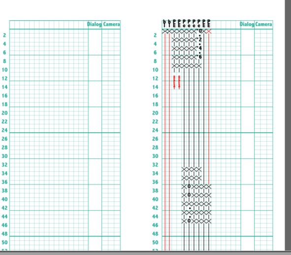

To get the X's and 0's to show as numbers on the sheet you need to mark them on the Timeline with the Image Marks (so for example, all Keys are marked with RED Image Mark , all Inbetweens are marked with GREEN Image Mark .
[click on images to enlarge]
The first time you generate the Timesheet by clicking on button "Sheet Key" it shows all the Keys (that have an Image Mark) , with the blank inbetween frames
shown as X's . When you have completed the Inbetweens those are also given Image Marks and then click on button "Sheet Inbetweens" , which generates a new set of columns
showing the KEY drawing numbers (circled in red) and the Inbetween numbers (not circled) . You must add a MARK OUT on the last frame (in this case frame 120) to have the RED line showing where the scene ends -
The new version doesn't work because the Font is too large , which makes it cramped and unreadable . (so this could actually be considered a Bug Report)

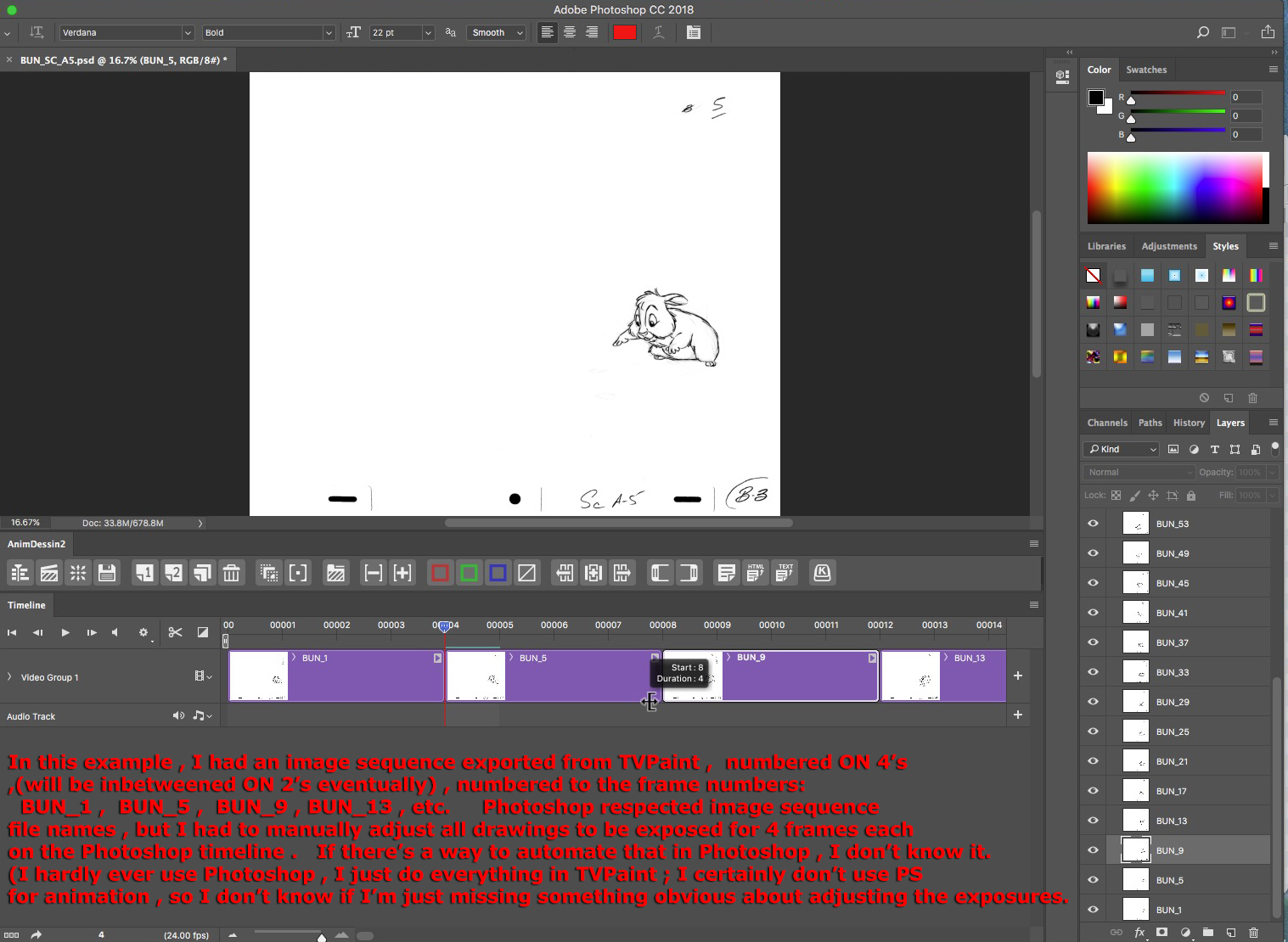

Ughhh ... full stop , darn it ... here's a major roadblock: everything worked perfectly up to the point when I imported the image sequence into TB . TB did not respect the image file names B1_ B3_B5_B7 _ _ _ B11 _ _ _ B15_ _ _ _ _ _ _ B23_B25_B27_ _ _ B31_ _ _ B35_B37_B39 _ _ _ _ _ _ _ B47_ etc , and instead it renumbered each imported image 1 , 2, 3, 4, 5, 6, 7, 8, 9, 10 , 11, 12, 13, 14 , etc. so there's no way to see at a glance what the exposure of each image is intended to be . This is a bust if there is no way to get TB to respect the file names .
Good news is that when importing the image sequence into Photoshop , PS does respect the file names, it doesn't renumber them like TB does. I never work with the Animation Timeline in PS , so I don't know if there is a way to select a group of frames and adjust the exposure (to be all ON 2's. or all ON 4's , or whatever it may be ...) The only way I can see to do it is to manually click and drag to adjust each frame to the number of exposures (1's , 2's , 4's, 6's , etc.) desired , which is very slow. There must be an automated way (?) but I don't know it . For some reason Photoshop's default is to import each image exposed for 120 frames/5 seconds on the Timeline (why Photoshop, WHY ?! That's just stupid ; why not have the default be for 1 frame each , then the user can adjust the exposure as needed) , so to adjust my imported frames to be the same as they are numbered in TVPaint and in the image sequence , I had to manually click and drag each frame to be exposed for the correct number of frames on the PS timeline . Yuck. That would take too much time.
In this example , I had a sequence of drawings exposed ON 4's (eventually to be inbetweened ON 2's) , but for now the numbering is ON 4's, matching the frame numbers 1 ____ 5 ____ 9 ____13 ____ 17, etc. You can see that PS respected the file names/numbers . But I had to manually adjust each drawing to be exposed for 4 frames on the PS timeline . I never use Photoshop for animation (or for much of anything else, I just use TVPaint for most things) so I may be missing something obvious about how to automatically adjust the exposure of each frame . The Anim Dessin add-on toolbar you see in the screenshot below does have a [ - ] and [+] button to take away or add exposures by clicking the button, but it only works one at a time as far as I can tell, unless there's some keyboard shortcut I don't know about which would apply the - or + to multiple selected frames all at once. There must be such a shortcut , right ? But where it is , I don't know ...
So I think it would work in Photoshop , if you can find a way to select a block of drawings and automatically convert them to be exposed ON 2's , 3's, 4's or whatever they may be, instead of having to manually adjust each drawing, one at a time .
Or, if you can find a way to force TB to respect the image sequence file names instead of renaming them when it imports & vectorizes them , it would work. I hope maybe it is a step in the right direction for you ... good luck.

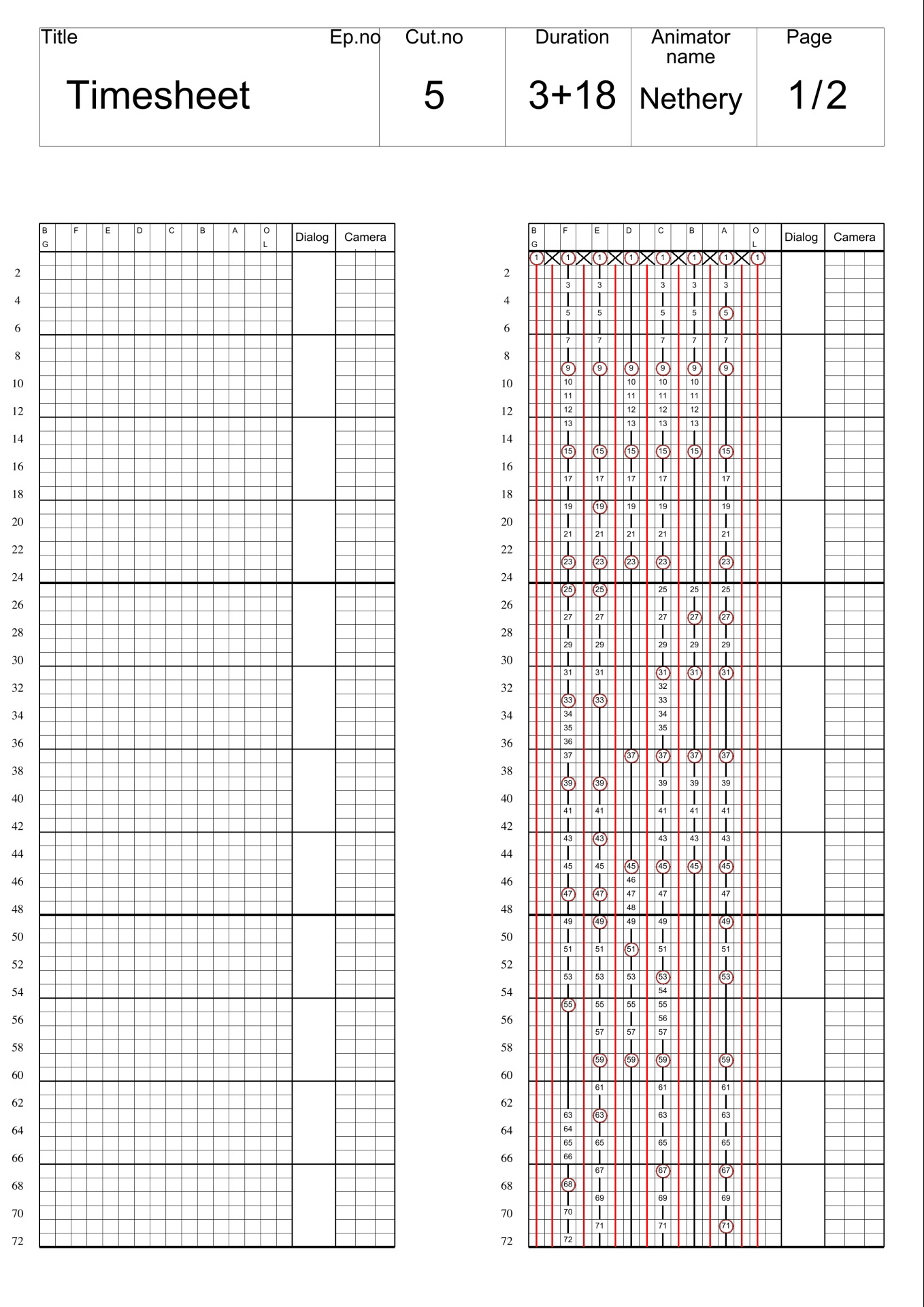

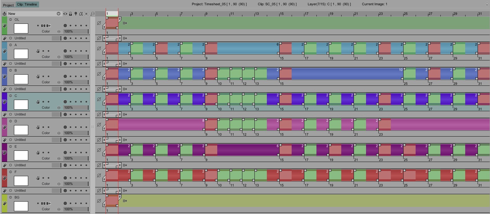

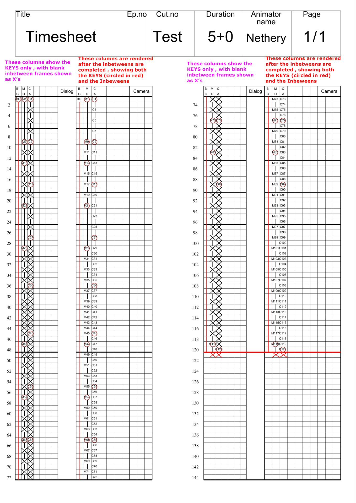

I hope you can fix the font size issue for non-Japanese versions. In the meantime a workaround to make the X-sheet more legible is to insert a BLANK (untitled) layer between each animation layer , so it adds a space between each layer on the generated exposure sheet (I'm assuming "Timesheet" is the preferred Japanese term ? In my 30 years in the industry I've never heard an Exposure Sheet referred to as a "timesheet" ... X-Sheet , sometimes Ex-Sheet , or Dope Sheet (mostly in Canadian and U.K. usage , rare for U.S. studios to refer to "dope sheet" , the more common term is X-sheet) .Thierry wrote: ↑29 Jan 2018, 14:31Well, I've made it so the Timesheet uses a Japanese font which takes less space. I don't know why it's that big on non-japanese versions though... I don't know if I can change that easily without interfering with the "intended" font, but I'll check when I'll have the time.D.T. Nethery wrote: ↑29 Jan 2018, 14:09On the current version of the Timesheet , is there any way to adjust the size of the font used , so it isn't so cramped ? What do the Japanese studios do when the numbering in their scenes is in triple and quadruple digits ? The sheet becomes unreadable .

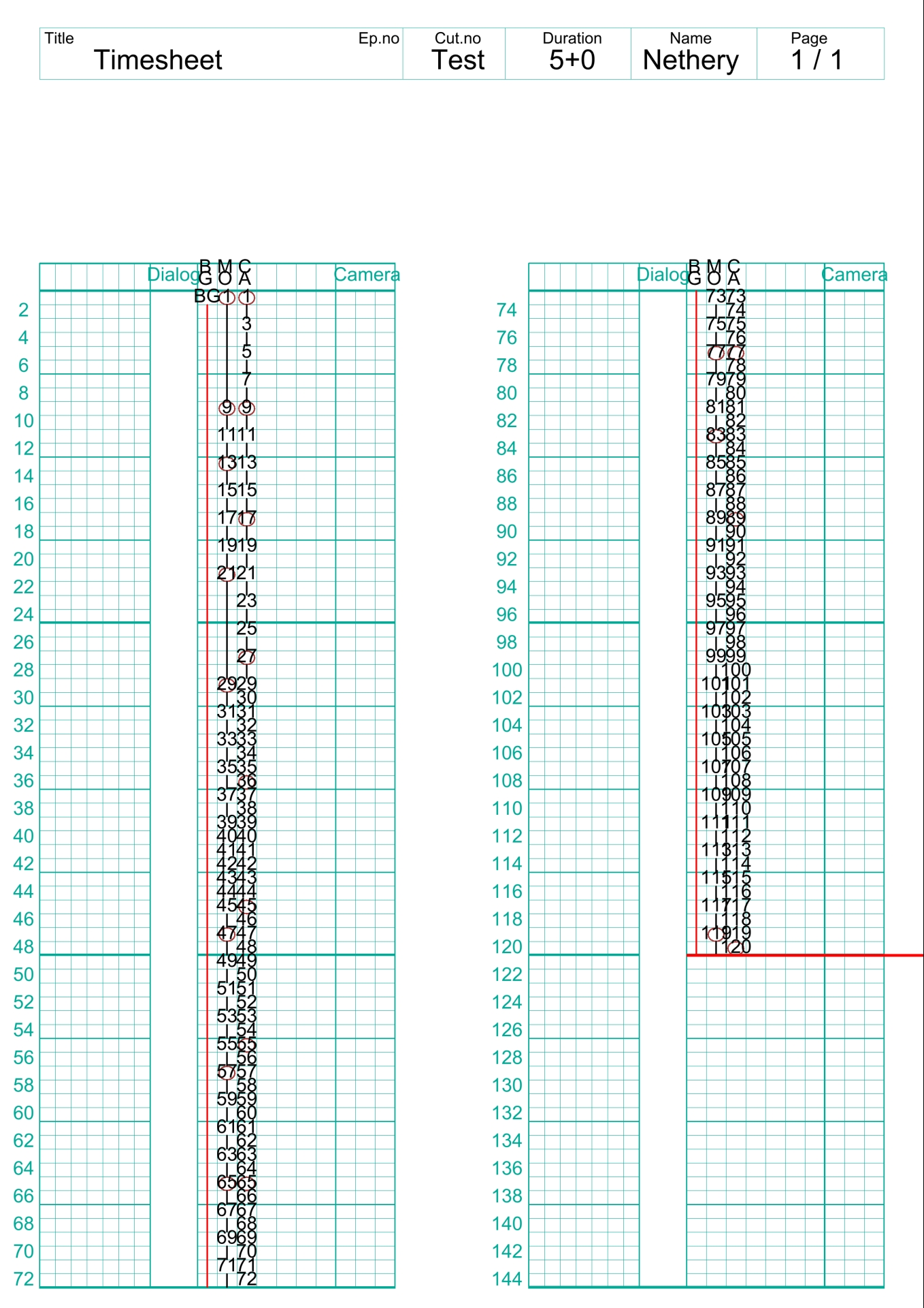

Also , it is more legible if the layers are named with simple one-letter prefixes - A - B - C - D - E - F , etc. Two-letter prefixes like OL (overlay) or BG (background) work .
In the example shown below , I have a scene with 6 animation layers ( A- B - C - D - E- F) plus an OL layer and a BG layer . Notice each layer has the untitled blank layer inserted, to provide for a space on the generated X-sheet (timesheet).
The old version Sheet 7.5 is shown for comparison for how much cleaner the numbers read . (this also has the extra blank layers inserted to create spacing between each layer)
A question: what is the purpose of including the Dialog and Camera columns ? Because as far as I can see no Dialog or Camera information from the TVPaint project is generated on the sheet . So , to me those columns seem to be extraneous , taking up valuable space that could be allocated to making the "boxes" on the X-sheet columns larger so the numbers are not so cramped . Do the Japanese users annotate the sheets by hand writing notes in the Dialog and Camera columns after they print out the sheets ? (does this mean they have some animators or inbetweeners drawing on paper , so the X-sheet is printed out , then Dialog and Camera notes are added for the reference of the artists working on paper ?)
If those two columns are going to be kept as part of the Timesheet , then at least abbreviate them to Dial and Cam , to save space, because notice how cramped the words are in the current version .
