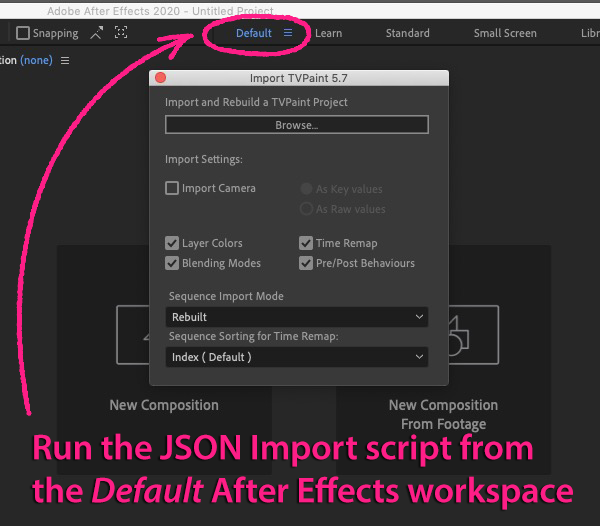

I updated to Adobe After Effects 2020, version 17.6.0 (Build 46) . The JSON import script appears to work as expected , except that it must be run from the DEFAULT
AE workspace . Then after the import is completed , you can switch to using a different AE workspace.
You might want to insert a note into the User Manual about using the DEFAULT After Effects workspace , because otherwise it can be quite frustrating to new users who are unaware of this workaround. https://www.tvpaint.com/doc/tvp11/index ... xport-json
Run JSON script from DEFAULT AE Workspace.png (89.1 KiB) Viewed 108395 times

Yes, that is the workaround which has made the JSON import script usable for some time now (two years?) , but the workaround is not well known because it is not mentioned in the User Manual or in the video tutorial - https://www.youtube.com/watch?v=YayOsWHXQZo . The user manual and tutorial need to be updated to include the vital information:
"You must run the JSON Import Script from the Default workspace in After Effects . After that you may switch to using any of the other workspaces in AE , such as Animation workspace or your own custom workspace."
