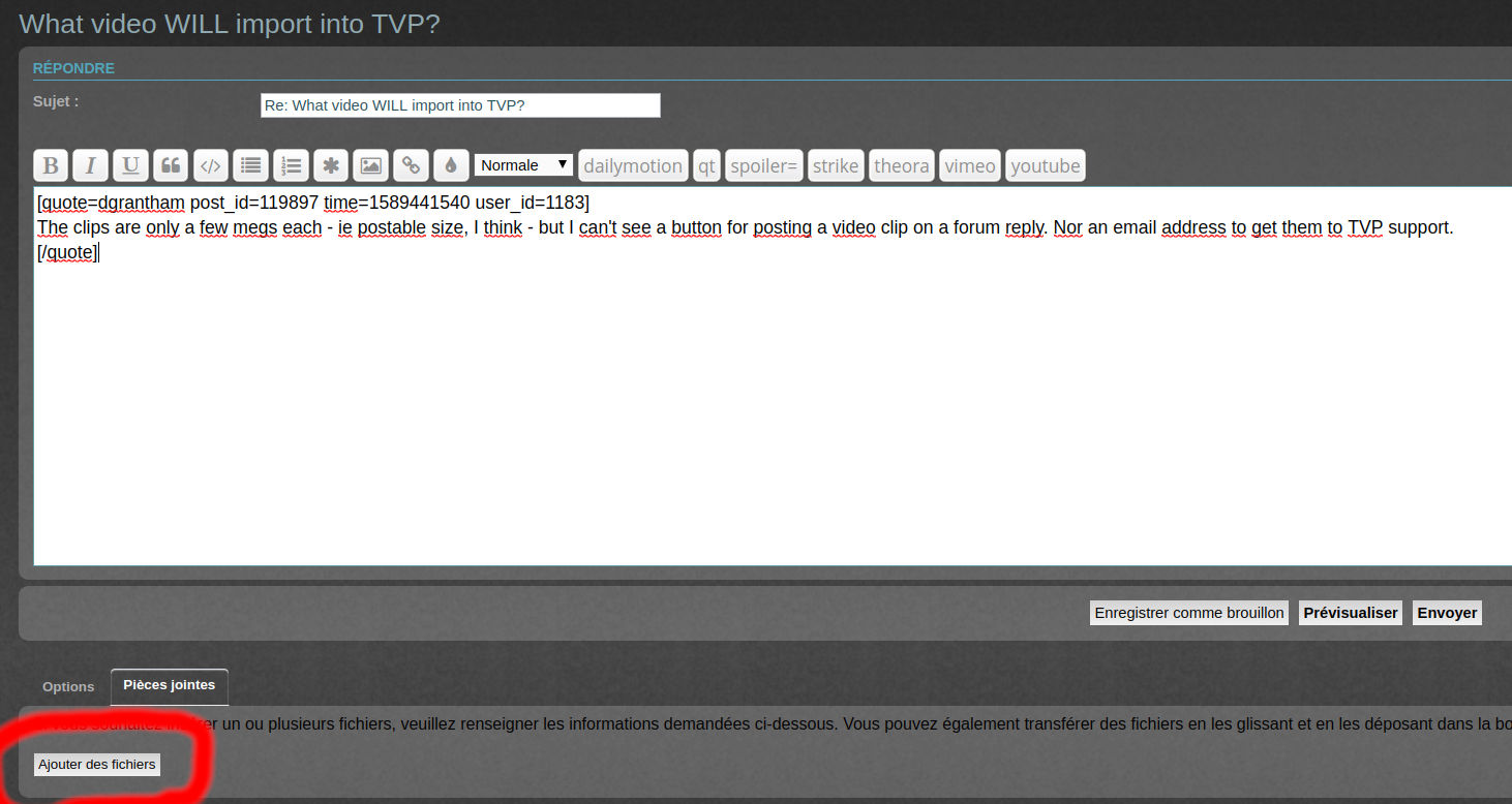

Re: What video WILL import into TVP?
You're right, TVPaint doesn't provide their emails publicly. Plus I'm not from support.
I can't see a button for posting a video clip on a forum reply.
Just use the button that says "Attachments > Add Files" to upload a video file.
See attached video I uploaded as test.

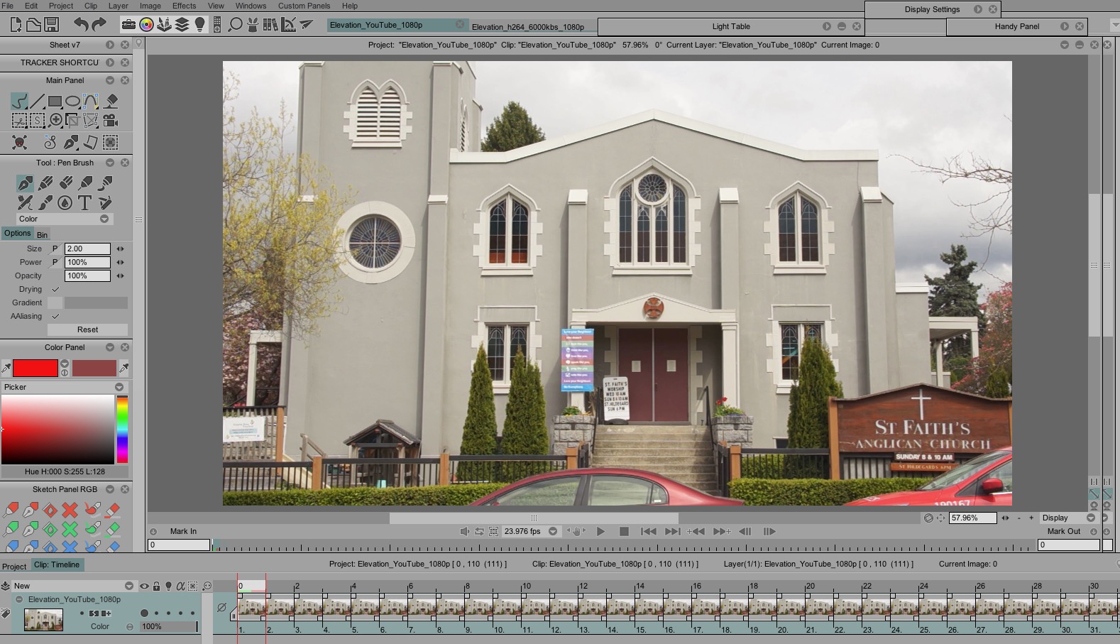

Both of the files you uploaded Elevation_h264_6000kbs_1080p.mov and Elevation_YouTube_1080p.mp4 loaded into TVPaint 11.0.8 on my end.
I noticed both sample files are a still image (?) . There is not any movement , although there are individual frames which imported into TVPaint
Are the original files a non-moving image ?
It's 24fps video of a church facade; the leaves on the leftmost trees should be rustling a bit in the wind.
Yes, I see that now. The leaves are moving slightly. I just wanted to be sure that the video had imported correctly.
