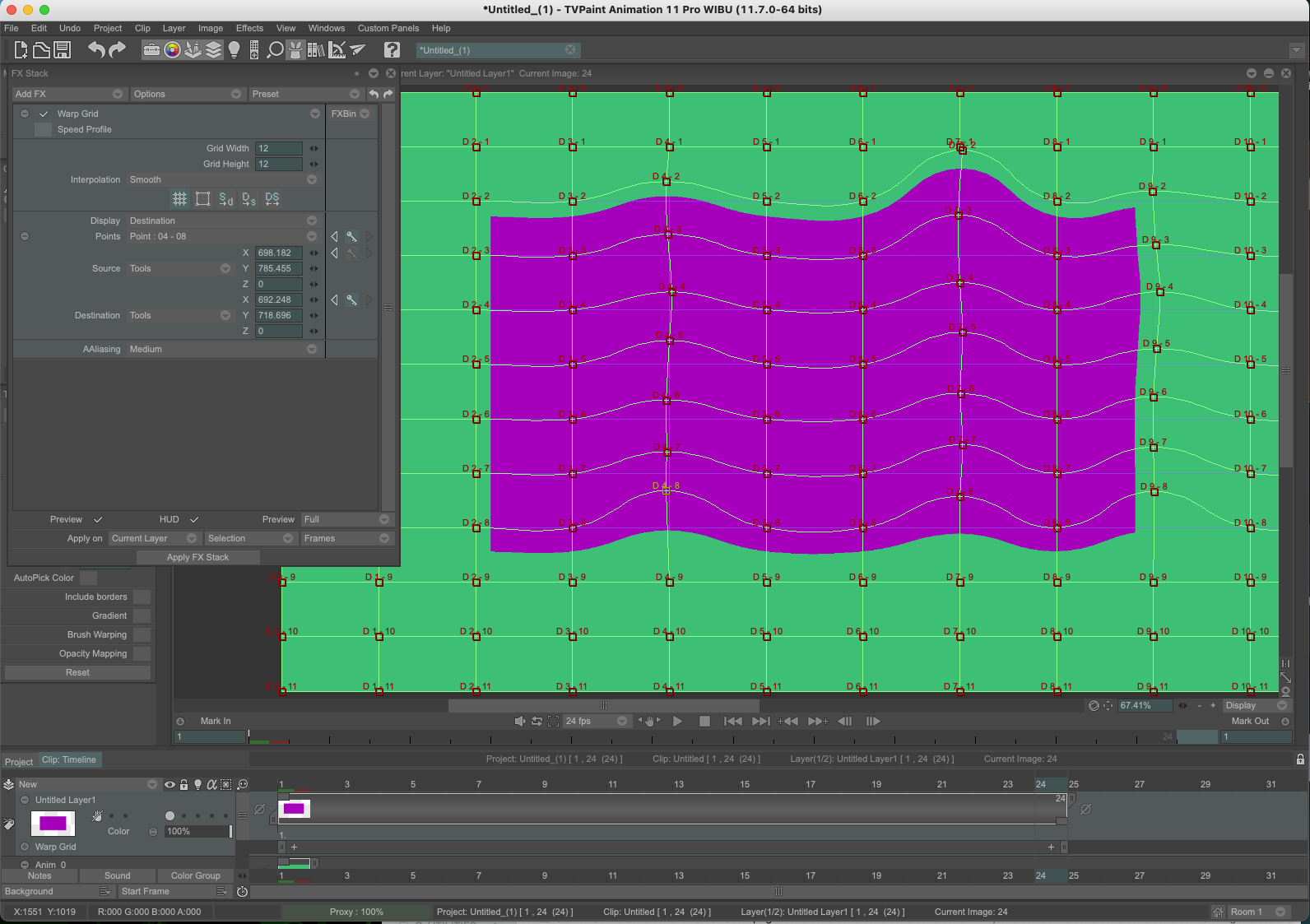

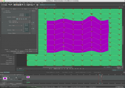

Here it is in version 11.7 (all points on the grids are visible) -

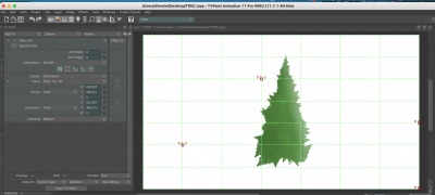

But here is the problem in version 11.7.1 (only a few of the points are visible on the grid) -

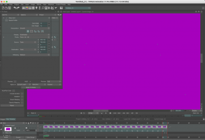

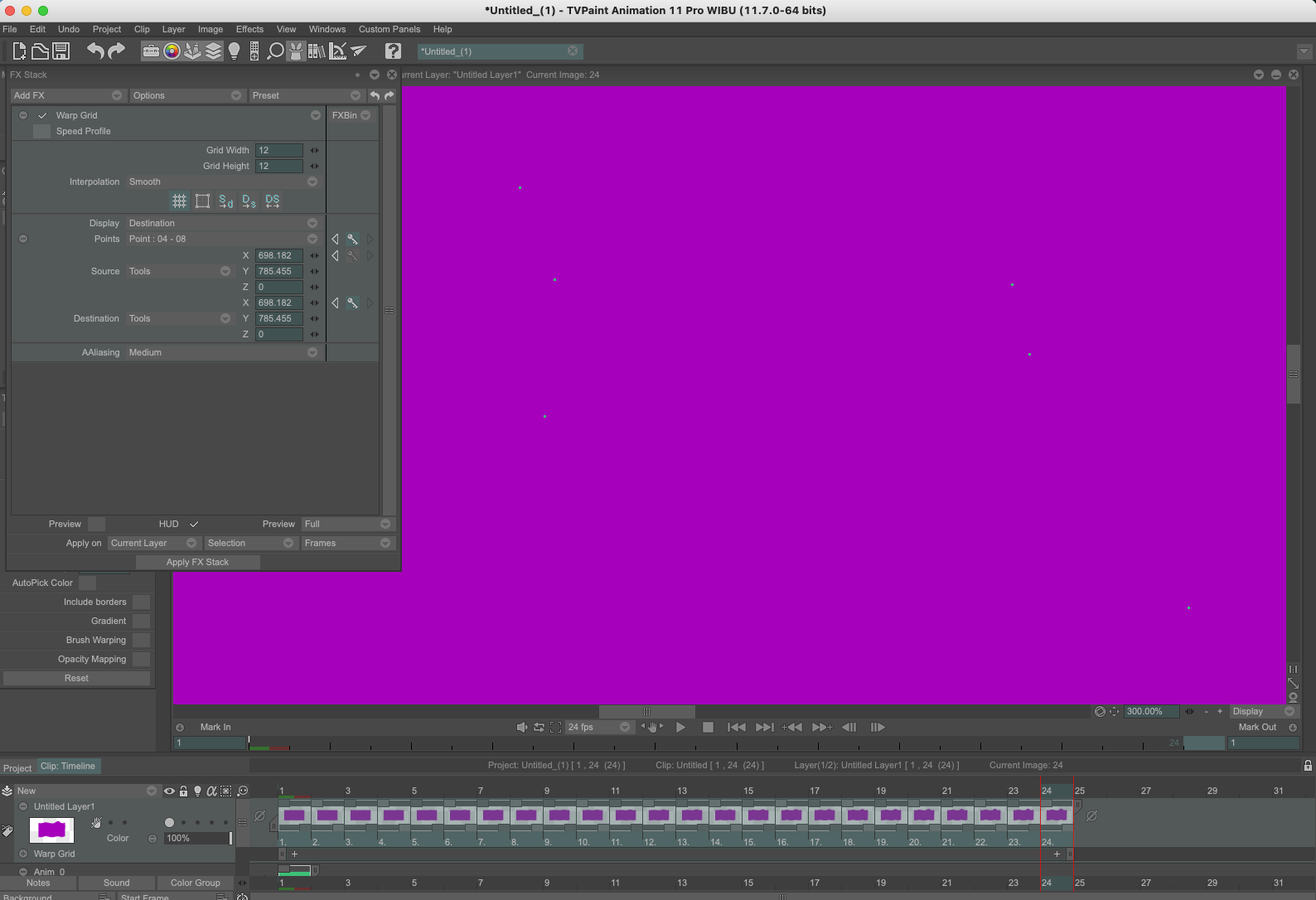

Here is the Warp Grid artifacting problem seen in version 11.7 (also in version 11.5.3) -

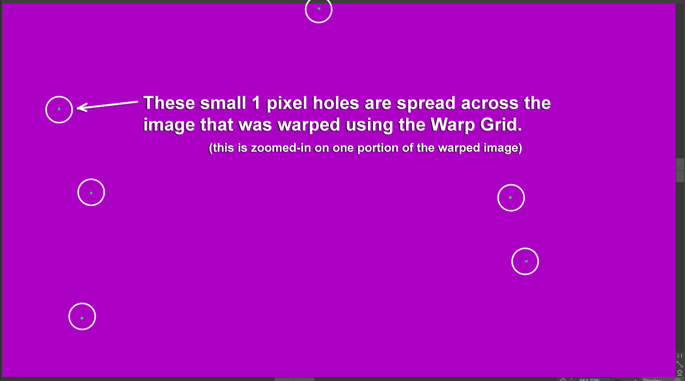

Warp Grid results (click on image to view full size to see the holes)

Thank you for your report with all screenshots. I succeed to reproduce the holes issue but also the handles of grid partially hidden. This last issue happens only on MacOS. I'm going to add these both issues in our issues database for further assessment.

Putting aside the artifacting problem (which has been around for years) , is the more recent problem with the points/handles on the Warp Grid being hidden (in MacOS version only) in 11.7.1 not something simple that can be fixed by restoring whatever line of code that got corrupted up in the update from version 11.7 to 11.7.1 ? Because the Warp Grid interface still worked correctly in version 11.7 (and 11.5.3 before that). So what happened from 11.7 to 11.7.1 that broke the Warp Grid interface ? Is it difficult to restore it ?

I noticed recently that another user reports the bug where the handles of the Warp Grid are partially hidden. You wrote: "this issue happens only on MacOS", but the user who reported the bug , TheInsaneum , is running TVPaint 11.7.1 on Windows 11 64bit . See here: viewtopic.php?p=131827#p131827
TheInsaneum writes:
TheInsaneum wrote: 19 Jan 2023, 15:28 btw. this is another a minor bug I found so I might as well add it here instead of making a new thread about it but when using the Warp Grid FX only some of the red warping handles show up and when toggling preview off and on you get a new random selection of handles. It doesn't make it completely unusable but does make it much slower to use the FX if you're having to roll the dice until you get the handle that you want to change.
