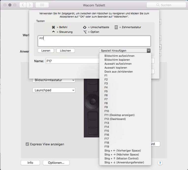

  4. Now you need to set these three F-keys in the Wacom Preference Panel. You find them in the dropdown I attached (I can't tell what its called in English).

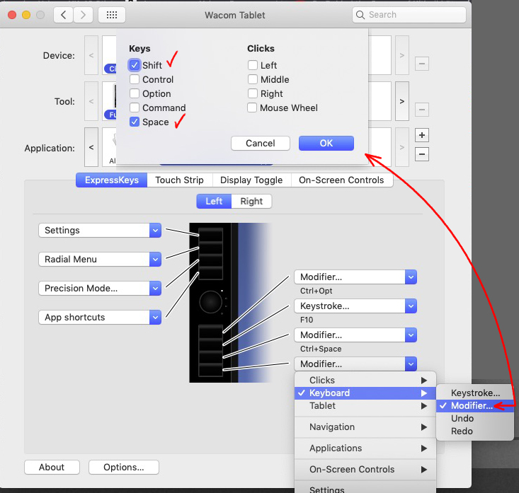

Bildschirmfoto 2021-03-06 um 12.30.01.png (86.34 KiB) Viewed 16506 times

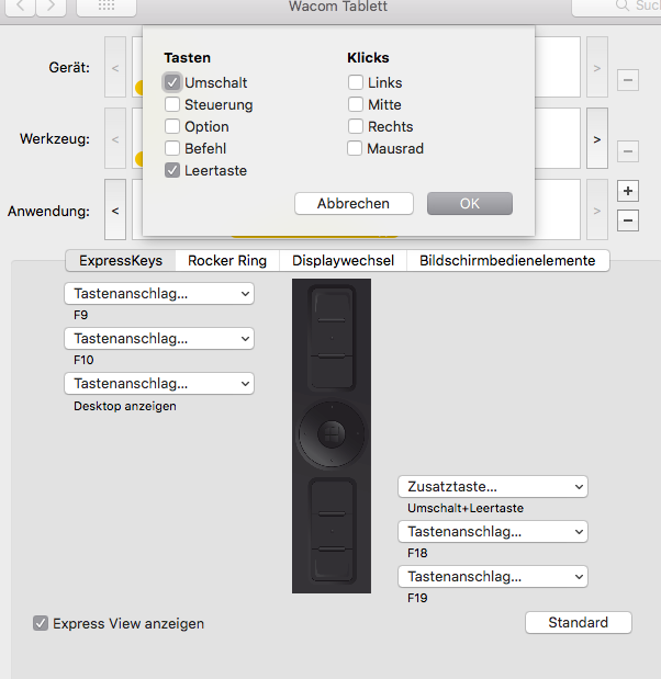

SHIFT +SPACE worked when I assigned it to one of the Wacom Express Keys !
I have three manual Flips: Flip KEYS only , Flip KEYS and BREAKDOWNS , Flip ALL. So I assigned SHIFT+SPACE to Flip KEYS only.
Next I tried to assign CTRL + SPACE to Flip KEYS and BREAKDOWNS . Guess what happened ? Yes , I got a weird line tool that pops up. :cry:
I looked for CMD+SHIFT on the list of available shortcuts in TVPaint, but it doesn't exist. Too bad , because Wacom's Modifier's include Command.
I hope TVPaint Developers can figure out how to fix the problem. It is so frustrating that this only occurs with shortcut keys assigned to Flips Manual . Any other shortcut assigned to a single key such as F, G , H , etc. will work with a Wacom Express Key to trigger it's assigned function, but not for Flips Manual. I suppose for Flips Manual it is as you mentioned: the keys must be pressed down constantly while in use , but the Wacom Express Key sends it as a "tap" not a "press and hold" .

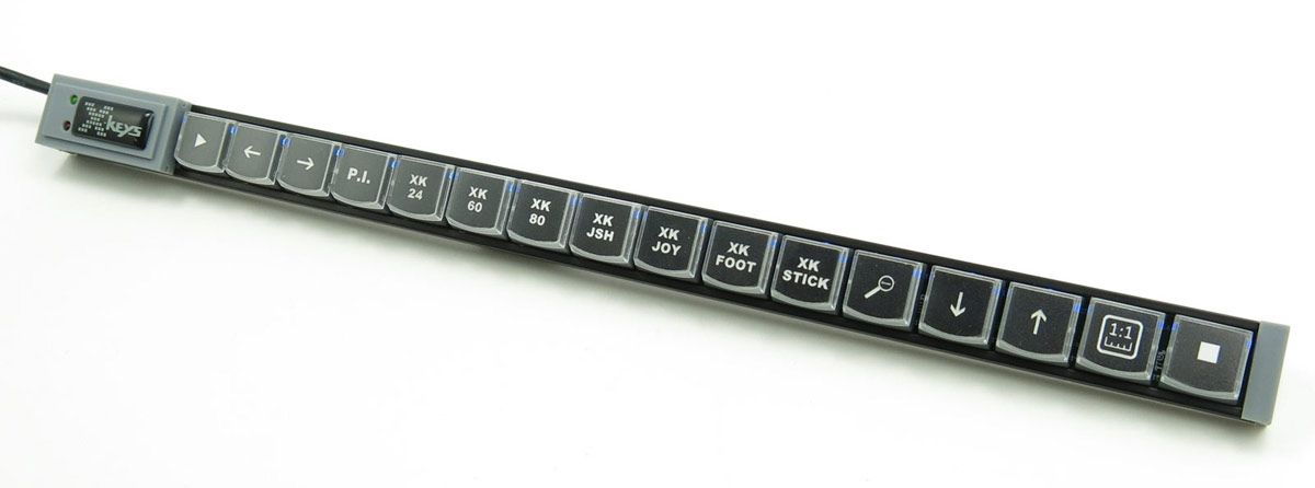

I've been meaning to try one of these X-KEYS sticks with programmable keys - https://xkeys.com/xk16.html I saw pictures of some animators at Pixar using these on their Cintiqs when they were animating on the short film "Kitbull" . A friend of mine who I knew from my time at Disney worked on it and he told me about these X-KEYS . What has kept me from buying it is that the software used for programming the keys is Windows only , however once programmed the macros are stored on the device’s MCU, so the unit can then be brought over to a computer running MacOS. But I don't have a Windows computer to do the initial programming. I suppose I could borrow one.
Cintiq Xkeys_strips.jpg (58.45 KiB) Viewed 16503 times
