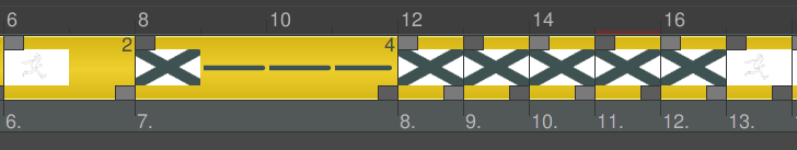

D.T. Nethery wrote: 07 Mar 2022, 22:52 Blank frame indicated with checkerboard , plus extended horizontal dotted line showing the duration of the blank frame would be ok.
I still like marking the blank frame with an X and the extended horizontal dotted line showing the duration of the blank frame . It appeals to me because it hearkens back to ye olden days of Exposure Sheets where it was industry-wide usage to indicate a blank frame with an X and a (vertical) line extended down the sheet to show the duration of the blank frame.
A quick glance at the Exposure Sheet shows where there are blank frames, indicated by X .
Hi David, I'm afraid that using a red cross to mark the empty frames would disturb the "eye" of some users. In my opinion it should remain discrete.
Re: empty frames
Xavier wrote: 08 Mar 2022, 13:04
I think the point is that the frame is marked in a highly visible manner (in my example by an X ) so the blank frame is very obvious and can not be overlooked. As I understood it , the original request was not about making a blank frame discrete, but about making a blank frame obvious to easily see it on the Timeline. It doesn't need to be a red X . That just seemed more visible to me and could not be overlooked. A greyed X and horizontal line indicating the duration of the blank frame would work. But to fulfill the original request I don't think the blank frames should be discrete. The problem was stated as:
"I'd like to have the option to make empty frames (instances) visually different from others. Maybe grayed out, or with a horizontal line, like in old X-sheets." and Peter's follow-up comment: "with the increased project resolution of today,
it is often very hard to tell if a frame contains a drawing."
If the blank frame is "discrete" , how does that solve the problem ?
To my eyes , comparing the proposed checkerboard pattern on the blank frame vs. X , the X is more visible.
[click image to view it full size]

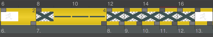

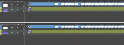

So here's a preview :
  • if either "put an X" or "identify empty instances" is checked, when zooming out:
    Capture d’écran_2022-03-09_13-11-24.png (9.91 KiB) Viewed 8969 times
  • when "identify empty instances" is checked:
    Capture d’écran_2022-03-09_13-09-07.png (12.07 KiB) Viewed 8969 times
  • when "put an X" is checked:
    Capture d’écran_2022-03-09_13-09-59.png (13.78 KiB) Viewed 8969 times
  • if you prefer to combine the two options:
    Capture d’écran_2022-03-09_13-16-47.png (13.65 KiB) Viewed 8969 times

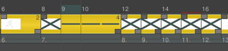

D.T. Nethery wrote: 09 Mar 2022, 20:46 I know you're going for maximum visibility of the X on the timeline (which is good!) , but I think I agree with Slowtiger that the X is a little bit heavy , perhaps just lighten up the stroke a bit ? But it doesn't really bother me if you left it as shown above.
I like having the different options you are providing in the Preferences ! Thank you.
That's an easy request ;)
So ... rather like this ?
Capture d’écran_2022-03-10_10-43-50.png (11.64 KiB) Viewed 8876 times

By the way ... I came up with the vertical bar because I was a bit tricky to resize the X, when zooming out. And finally I think the checkerboard pattern would be sufficient by itself, to notice the empty frame.
So what would you think, if I simply let the checkerboard pattern on empty instances and/or the X ? and the vertical bar only on small zoom ?
Re: empty frames
Xavier wrote: 10 Mar 2022, 12:10
Yes, I think that looks good.
