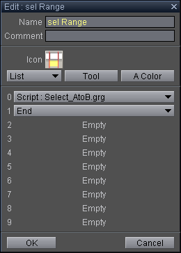

Do you now how annoying it is to try and select 1000 frames inside an Xsheet layer? Since I can only click&drag to select, there's no shortcut, like selecting a start frame, scroll down to the end, and shift-select the end frame. (Selecting all frames wasn't an option here.) Same goes for extending an Xsheet layer: the dragging goes very slowly, at about 4 frames a second. It doesn't help that trying to drag a line between two Xsheet frames doesn't work if the playback head is somewhere else: it will jump to that position and I have to find my working position again. I have to first click a frame to ensure the playback head is where I work.
The first/last page keys work to select the first and last frame of the selected layer, but the page up/down buttons do nothing, as well as my scroll wheel. Annoying to always have to click into the scrollbar.

as work-around, I use to spot the end-frame position (B), the start-frame position (A),
then use a custom "Select Range" button. (see pict.)

agreed, I've asked for that (LMB-click a start frame, and shift-LMB-click the end frame) about one year ago, because shift-click&drag is scrolling very sloooowly when reaching the botton of the XSheet window...slowtiger wrote:... Do you now how annoying it is to try and select 1000 frames inside an Xsheet layer? Since I can only click&drag to select, there's no shortcut, like selecting a start frame, scroll down to the end, and shift-select the end frame ...
- SelRange.png (5.33 KiB) Viewed 21928 times
