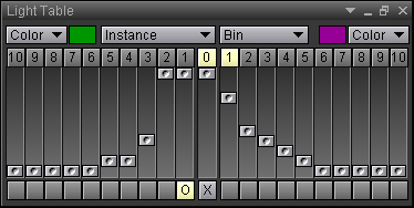

I have tested the off pegs flipping feature and I can say it is better now than the normal flipping feature (default key:w) but there is still a little glitch:
When you keep the key pressed you have a glitch when the cursor comes back to the first frame (you can see for a very little time the cursor going back and some images are displayed an instant).
This is a bit annoying. But more annoying is the normal flipping feature (with "w"): If you want to flip between 3 frames you have to set your preview settings to 0.15sec, and the last frame is always displayed as a glitch. If you want to flip between 5 frames you set to 0.25sec but here again you have the last frame displayed as a glitch.
first of all, eliminating the glitches bugs should be a priority butI would like to make this proposition for a future feature :
Since the flipping light table is now a nice feature easier to use and tweak then the normal flipping feature would it be possible to flip it in 2 ways.
-Flipping with the out of pegs
-flipping without the out of pegs.
When animating we could then flip easily with the same amout of frames out-of-pegs and in-pegs for quickly checking the general movement and the inbetween details. Here we could have a functionality impossible on paper (until now paper was still easier to use for precise work).
I guess this "feature" can be simulated right now by using a shortcut for flipping the light table and using the hand-flipping-icon for flipping normally (It would be nice to have the 2 features accessible as an icon as well as a shortcut key ^^ )

The auto-trim feature is explained here in the second part of the movie.
(Personally I don't really care about the smooth feature but I am very eager to test the auto-trim thing ^^ )
viewtopic.php?f=21&t=3966&p=32679&hilit=smooth#p32678" onclick="window.open(this.href);return false;

isd wrote:The auto-trim feature is explained here in the second part of the movie.
The auto-trim feature is explained in the movie above from 8:25
