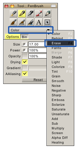

Any drawing tool can be set to erase. Look at the little window below the Tool: panel where it probably says color right now. Change that to erase. Ask away because there's more you'll like, such as the ease with which you can create your own pencils, erasers with your own icons in something called the Custom Panel.

And the Erase is in fact a mode for you brush, like Color, behind, tint, multiply etc...
It means any brush can be what you want. :D

Eraser TIP: Select the oilBrush tool to be you eraser -- you'll never want to use the oil tube in any other way anyway. To make just the eraser you want (or several of them to save in the bin), click on the B&W square that looks like a diving flag and your profile editor will open. Drag the middle of the diagonal line to the bottom to create a flat eraser. The shape represents just half of your tool tip. Set percentages of pressure (Power) or click on the little P box to find all sorts of other options. If you select None, your little box will show the letter "C" which stands for Connection Settings. Those you can set by opening OPTIONS in the same drop down menu.
