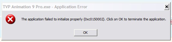

downloaded and ran TVP_Animation_951_Pro_MIR.exe which installed TVP Animation 9 Pro.exe file - size 7,616kb - dated 9/7/2009 8:26 AM. Also installed Sentinel driver 7.5.0.
Clicked icon to run and got this error message. Rebooted. Same message. Removed and reinserted Dongle. Same message.
Sep. 08 tvp error message.jpg (14.31 KiB) Viewed 31617 times
what next?
Sven

Re: TVP Animation 9.5 is now available !
Post by Klaus Hoefs »
It seems to be a bug.
I reported it already.
You can reinstall the 9.05 without problems until this may be fixed.

Svengali wrote:downloaded and ran TVP_Animation_951_Pro_MIR.exe which installed TVP Animation 9 Pro.exe file - size 7,616kb - dated 9/7/2009 8:26 AM. Also installed Sentinel driver 7.5.0.
what next?
Sven
Install the last service pack and xp update
Hervé ADAM, TVPaint Team

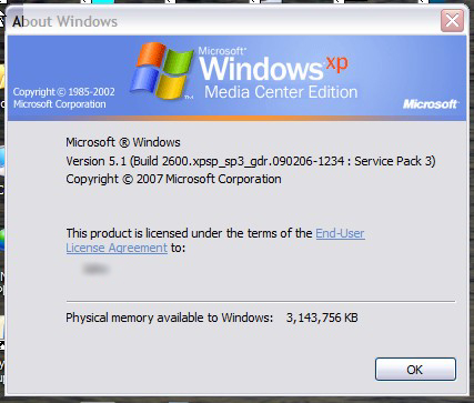

Service Pack 3 is already installed... is there more I need to download from Microsoft?
Sven

This crash appear here on an old PC with a not up-to-date XP, a full XP update ( start->Microsoft Update) fix the problem.
If you don't want update your system, you can try to install this:
http://www.microsoft.com/downloads/deta ... 9C36F85647
http://www.microsoft.com/downloads/deta ... 4b9f2bc1bf
http://www.microsoft.com/downloads/deta ... 02b2af5fc2
http://www.microsoft.com/downloads/deta ... DA479AB0D7
