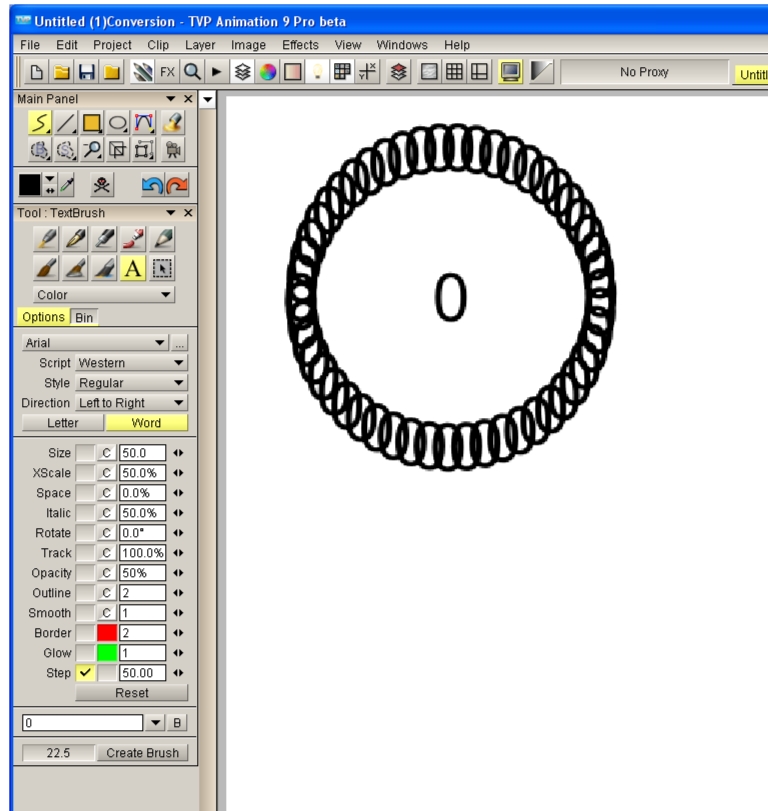

ZigOtto wrote: about your Chart tool, it looks very handy as well, at least when working in a team,
with assistants and inbetweeners, the only thing I can't get rid of, is that the nb
and the circle (or under-bar) are not centered here, I don't know why actually,
maybe something to tweak in the tvpa text tool settings, I've tried with different fonts
at different size, it's always (vertically) offset ... :? (see pict.)
thats a strange off set must be some setting in the text panel that is different between us.Lets find out

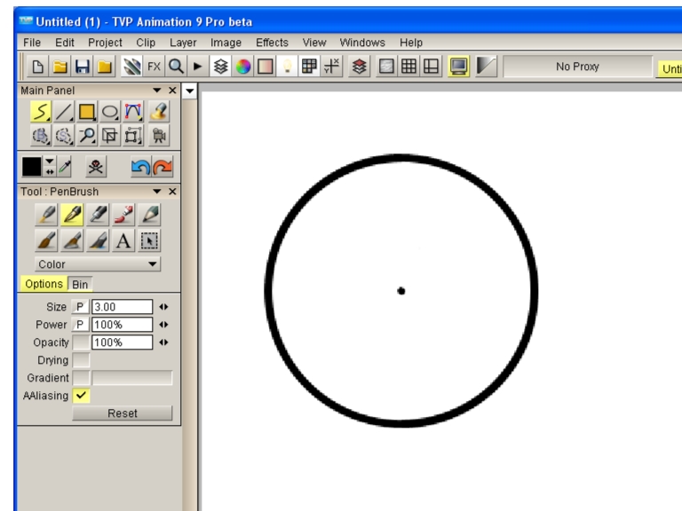

Ok lets test this script Zigotto and compare
Code: Select all
tv_Dot 150 150
tv_circle 150 150 100
I have tested it with the pen brush
and text
is it the same on your computer Zig?
Re: Mads Juul Panel
yeap, idem result here ...
it should have been something to do with the handle position with the text tool,
I just changed your line : "g = yf-(textsize/3)" by "g = yf " and it seems to work fine now .
(and the tv_rectfill line too : >> tv_rectFill xf-dia yf-dia xf+dia yf+dia)
in the break-down script,the 2 lines modified are :
Code: Select all
	 tv_Line xf-(radius) yf+(radius*0.8) xf+(radius) yf+(radius*0.6) 0
