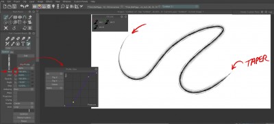

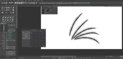

To get a tapering (peaked) line at the ends , you could try setting the Size of the RR Ink brush to P (for Pressure) and open the curve editor for the Pressure , adjust the curve until you get the shape tapering effect you want.
Or link the Size to F (Fade) with this kind of curve :

Thank you very much !
