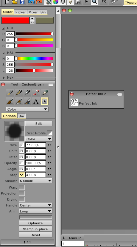

Thanks for doing this cartoonmonkey, but for some reason I still can't use any colour other than black! Am I missing something?

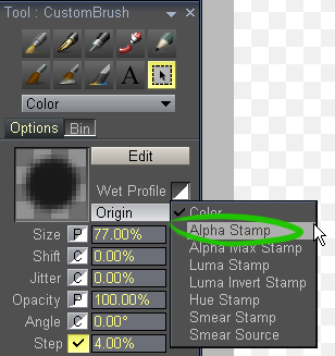

use it with setting the brush mode to Alpha Stamp instead of Color (Origin) ,
so it should draw with the current A color.
to re-save the custombrush : RMB the CBrush icon /Edit ... "Grab Current Brush",

Yes, if you want to save the brush with those settings, you can always click the black arrow in the animator's toolbar, TVPaint saves the brush along with all of it's current properties EXCEPT color. The red arrow saves the brush, all it's settings WITH color.
