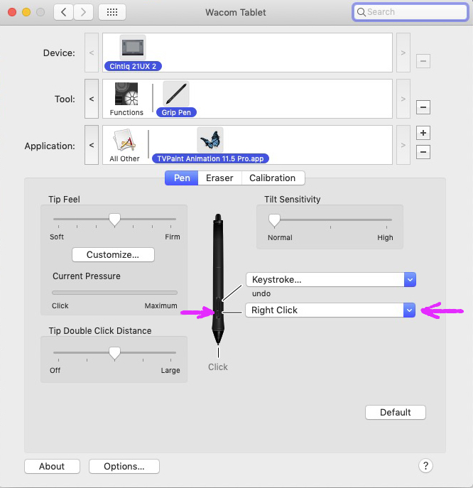

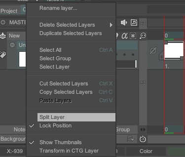

Wacom Pen button set for Right Click allows for hovering over any tool or layers on the timeline and by pressing the Wacom Pen button the menu options appear.
Right Click with the mouse will do the same.

Also with Wacom Pen button set to Right Click if you press the pen button the drawing mode automatically switches to erase mode. (for those users who prefer not to flip over their Wacom pen to use the eraser end of the pen to erase.)
