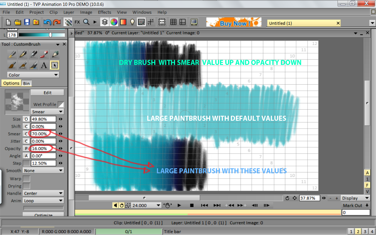

e1two
Posts: 14
Joined: 19 Feb 2012, 17:59
Re: smear brush.
Post by e1two »
Hi,
I redownloaded the latest trial just to make sure.
It's quite easy to replicate and goes back to the previous posts.
I've added a screenshot because a picture tells a thousand words.
The behaviour is always there but becomes more obvious
the more you up the smear value or the more you lower the opacity.
e1
Re: smear brush.
ok, thanks for the feedback. We will run some other tests tomorrow.
stay tuned.
idragosani
Posts: 987
Joined: 06 May 2008, 00:39
Location: Germantown MD
Re: smear brush.
Post by idragosani »
I just tried the exact same test, same brushes and same settings. The only thing that changed was the color tone, but didn't go to black (this is a pretty big canvas, too, so I scribbled a lot without lifting the stylus)
