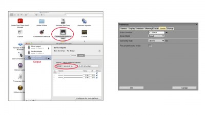

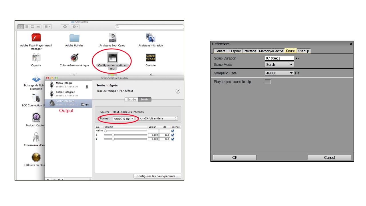

we used those settings on Mac and TVPaint (click to enlarge) :
On Mac, you also have to set the OS properly, as it was shown in the very first link that Paul added in this topic.

Fabrice wrote:we used those settings on Mac and TVPaint (click to enlarge) :
Yes, I have been putting the settings as recommended in the OS, as explained above, and I have still been having sound playback inconsistency issues.
