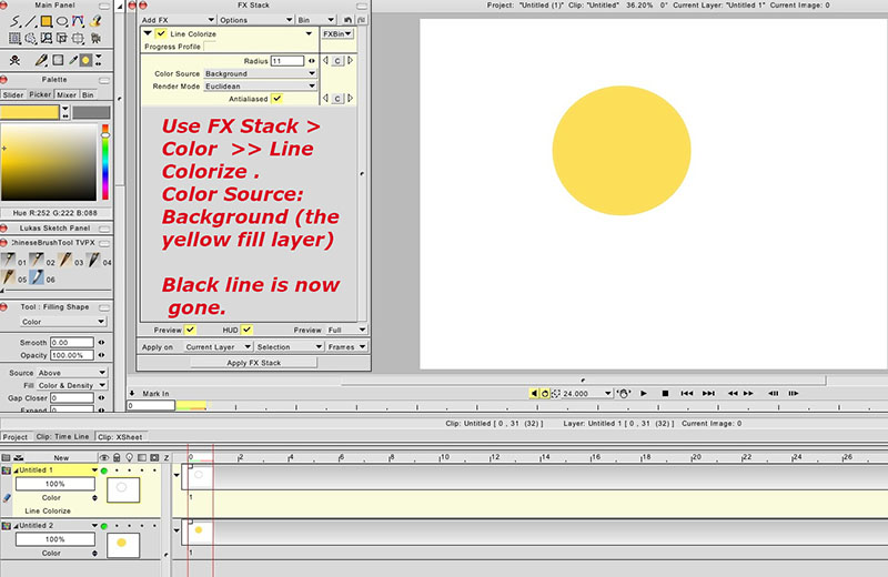

In addition to the other tips you've received from Slowtiger and others , it sounds like for what you want to do (get rid of the black outline) you may want to look at the new Line Colorize tool in the FX Stack. (TVPaint 10.5)SumGuy12314 wrote: If I draw a shape with the stroke tool using black, and then later I fill it in with yellow, the black outline will still show.. I guess this is my question now.
The path is FX Stack > Color >> Line Colorize .
See the attached images .

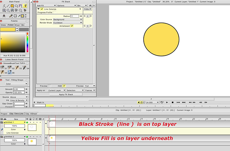

Draw the lines on one layer.SumGuy12314 wrote:Wait how do I separate the lines and fills in the first place...?

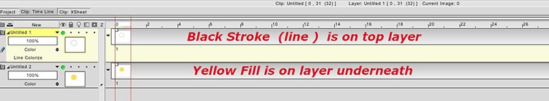

Create a new layer (under the lines layer) for the fill color . Two separate layers. As shown in the screen shots in my post above describing the Line Colorize FX.
Line art on top layer , fill color on layer underneath :

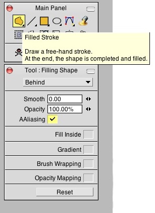

To add the fill color on the layer underneath the line art use the Flood Fill (Paintbucket) or Filled Stroke (freehand fill) in Behind mode , set to Source as "Above" (the line layer above is the source for defining the area of the fill color) .
Another way of doing fill colors is to have your line art on the top layer , with a new layer underneath it for the fill, and use the Filled Rectangle Tool set to "Fill Inside" . Then just draw a rectangle around the area you want to color and it will fill all closed lines within the area of the rectangle you drew. (again the Source layer for the fill should be set to "Above" so the lines on the drawing above are defining the area that will be filled. For clarity of illustration I'm showing a simple circle shape here , but all of this applies to coloring more complex shapes/characters. )
[NOTE: you can also use the freehand Filled Stroke tool with the "Fill Inside" mode ].
