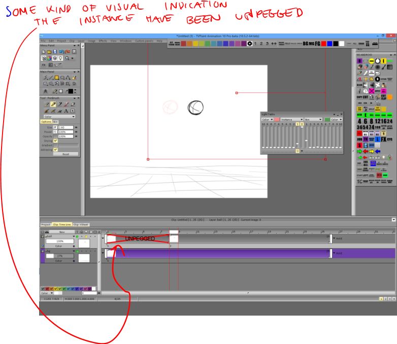

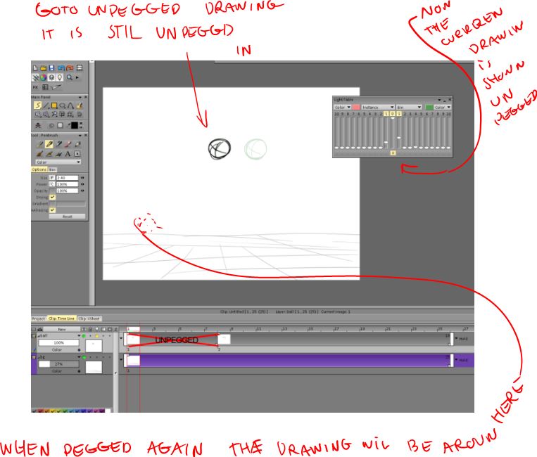

I guess the functionality would be completely different. It would be the actual Instances being un-pegged. and not the images shown in the Light-table.
I still think the light-table Panel would be a nice interface.
You could still un-peg you drawings
I think we would need a visual indication on an instance that it has been un-pegged. Like an image-mark or the instance name
And when flip to the Un-pegged Instance it would still be shown in the un-pegged position so you can drawn on it.
Also notice in the light-table panel. I have indicated that now is the current drawing un-pegged, with the yellow Square with an 0 inside

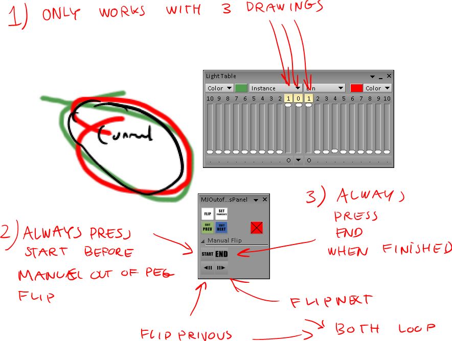

I just got an idea to another approach to creating flipping out of peg. I have made a proof of concept and put it in the MJ Out of Pegs Panel
Notes
1) Only works with 3 drawing current-previous-next
2) Always press the "Start" before manuel flipping the out of pegs drawings
3) Always press "End" bottom when finished with Manuel Flipping
4) You can only draw on the current image(Nitice I lock current layer with the script when I show one of the Lighttable drawings)
I dont know if this is usefull at all. just got the idea and wanted to share it
MJ Out of Pegs Panel 3.tvpx
(367.5 KiB) Downloaded 609 times

YES.. Everything mentioned in this thread previously by Mads and by Don is what concerns many traditional pencil & paper animators wanting to switch over to paperless using TVPaint. Just recently I have had this conversation with two former Disney animators who are now teaching at schools with TVPaint and trying to show their students how to do precise inbetweening with TVPaint. The general consensus is that the current Out of Pegs function is "ok" to a certain point , but would be more useful if it was as Mads and Don are describing. This is not to take away from what the development team has given us already , this is not a complaint about the current Out of Pegs function, but a request to push it further if possible.
Mads Out of Pegs custom panel is a good start.
Notes
2) Always press the "Start" before manual flipping the out of pegs drawings
3) Always press "End" bottom when finished with Manual Flipping
4) You can only draw on the current image (Notice I lock current layer with
I don't see it as a big problem if it only works with 3 drawings : current , previous, next , since that is how traditional inbetweening on paper is done , although some artists prefer to have more than 3 drawings in the stack and be able to flip around to previous and following drawings to check the current (top) inbetween drawing. But practically speaking, if you are inbetweening with the Light Table on then you really only need to to have Current , Previous, Next be active out of pegs.
"4) You can only draw on the current image"
... again to me that is not a big problem. That is the way it would be on paper. If you are drawing an inbetween you must assume that the two drawings being inbetweened are correct , so why would you need to draw on either the previous or next drawings which you are currently inbetweening ? If you find something was out of place with one of the drawings being inbetweened then you would have to fix that first ( "on pegs") and then go back to continue to draw the inbetween ("off pegs") , so to me not being able to draw on the previous or next while it is in the off pegs position is not a big deal, but if it were possible to do that then so much the better.
