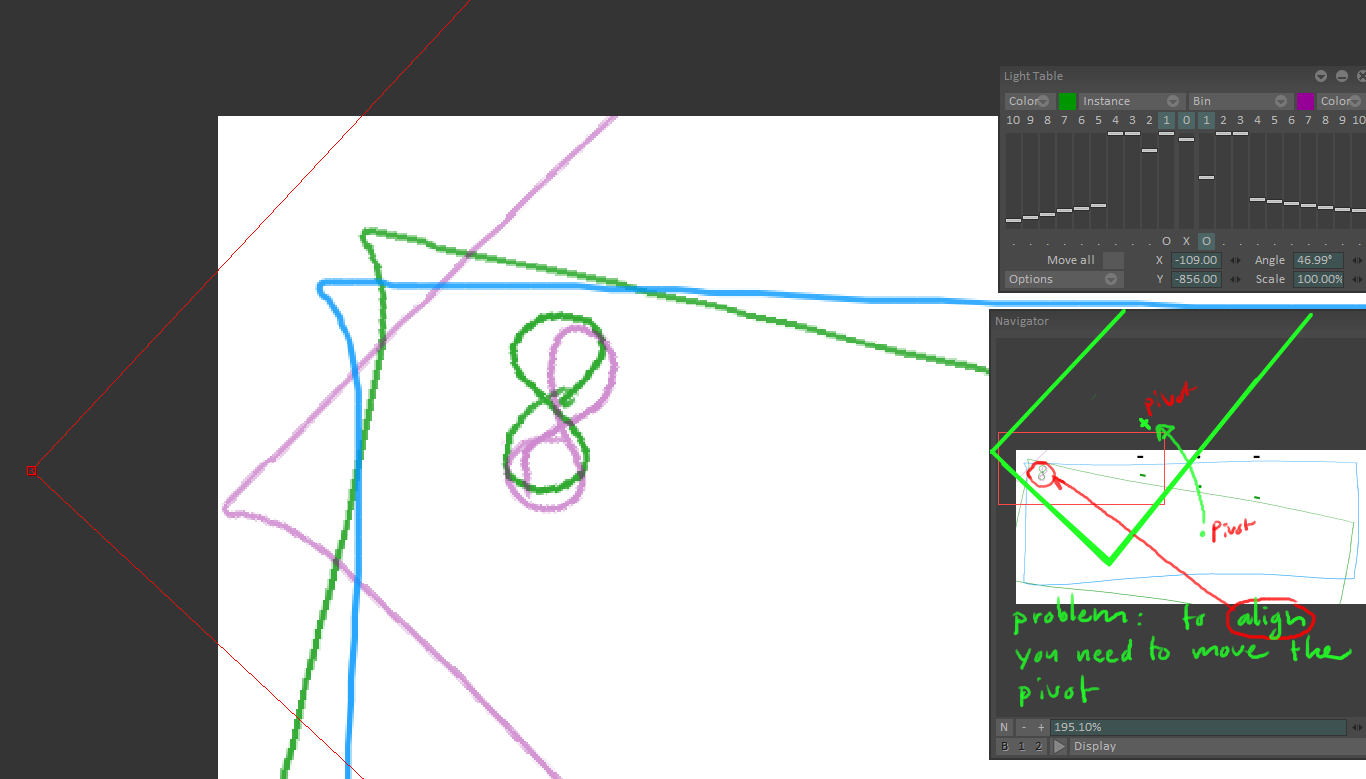

Posts: 4517
Re: Easier rotation Out-of-Pegs
momo wrote:I dont get this feature request since the ctrl +click is already letting you rotate the out of peg drawing at any zoom level.
While CTRL+click helps, there is still a problem...
And that is the alignment issue, this is most prominent when working zoomed in, in a corner of a large project.
the problem is in the position of the pivot.
Because the OOP rotation center equals the projectcenter, a rotation in a corner makes the drawing disappear from view.
So you then need to moove the OOP LightTable image quit a bit, and every subsequent adjustment to rotation requires more subsequent panning.
see image:
Posts: 4517
What is the status on this request?
to have the offpeg rotation pivot be in the center of the screen, independent of wherever the projectview is zoomed in at.
