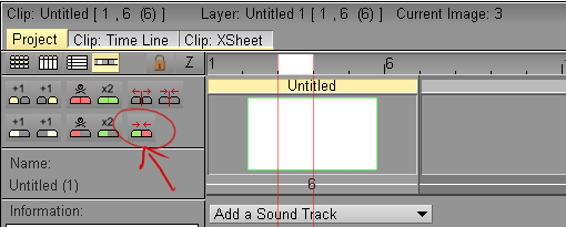

David_Fine wrote:So this is clear, thank you. My only question is that here we really have one single 60 frame scene, split into three x 20 frames in order to do the moves. So how do you change each scene to be those split parts? That is, lets say you have about 8 levels. Do you manually trim each level down to the 20 frames needed for the part 1, 2 and 3? That is, for part 2, you have to trim 8 levels on the left and the right. Or is there some simple way to select a section of all layers, hit delete and they are all deleted? It just seems like a lot of adjusting that could result in errors, but maybe I am missing something. Certainly in an app like Pro Tools, with multiple audio tracks, it's easy to trim a bunch of tracks in one quick move. Does TVPaint do this?
it's easy in tvpa as well, here's my way :
in the project tab (timeline view), navigate in the timeline and go to the position where you want to split,
(last image of the first part, in my example, 20i after the clip's starting frame),
then, simply hit the [split Clip] button of the Animator panel (or your corresponding assignated shortkey),
you will get 2 new Clips, renamed "clip-name Left" and "clip-name Right",
- repeat the process to split the right part in 2 clips,
then RMB-clic each part and rename them ("Rename Clip ..." command).
nb:
I personnally use this clip-splitting technique only at the final stage,
(in fact, just before the final export), to refine the camera move when it looks to need it,
before that, specially at the animatic step , I start with a rough camera set along the initial clip,
because its more flexible with one camera move (+ progress profile) on a single clip,
here you can test quickly different options, where you want the move start and end, at what speed,
when to stop and hold, the length of the sections (A>B, B-hold, B>C) one to the other, ...
and of course, tweaking the progress profile to fit any animation modification,
once everything "in place" and validated, I can go to split and make the camera move more "accurate",
f.i. to get a flat (hold) section perfectly flat.

Excellent. Thank you. I figured there must be some very straightforward way to split all layers and that's it! So you simply apply each camera move to each section. Easy. Can you rejoin a split clip? I don't see that button.
I also see that there is a button to separate a scene into two scenes. How is this different than separated a clip? Is it that the clip is maintained within one scene, but two scenes become two individual TVPaint files?
David Fine
Snowden Fine Animation Inc.
Vancouver, Canada
Re: Combining clips to make one output
David_Fine wrote:... Can you rejoin a split clip? I don't see that button.
yes, but only two in once, I mean it will merge only the current clip with the next one,
unfortunately, afaik, it doesn't merge the camera paths (I think it keeps only the 1rst clip's camera settings).
basically, this button copies the stack of layers of the next clip and paste them at the end of the current clip,
so if both the 2 initial clips had 5 layers each, the (resulting) merged clip will get 5 + 5 = 10 layers.
David_Fine wrote:... I also see that there is a button to separate a scene into two scenes. How is this different than separated a clip?
well, a scene is nothing more than a group of clip(s),
f.i. SCENE1 = "Mam in the kitchen", containing 3 Clips :
- Clip1 = "Mam is cutting vegetables",
- Clip2 = "she put them in the boiling water,
- Clip3 = "she reduce the heat and stir",
you can take out a clip of a scene to make it its own scene, or to join it to another (existing) scene,
Split and Join Scene(s) works only with full clips, (you can't split a scene in the middle of a clip).
it's more explicit in the Project tab / thumbnail view, just clic the clip's headbar and drag it out of the scene,
or into the neighbouring scene to join it.
you can also permute (changing the order of) 2 clips just by "clic & drag" one over the other.
