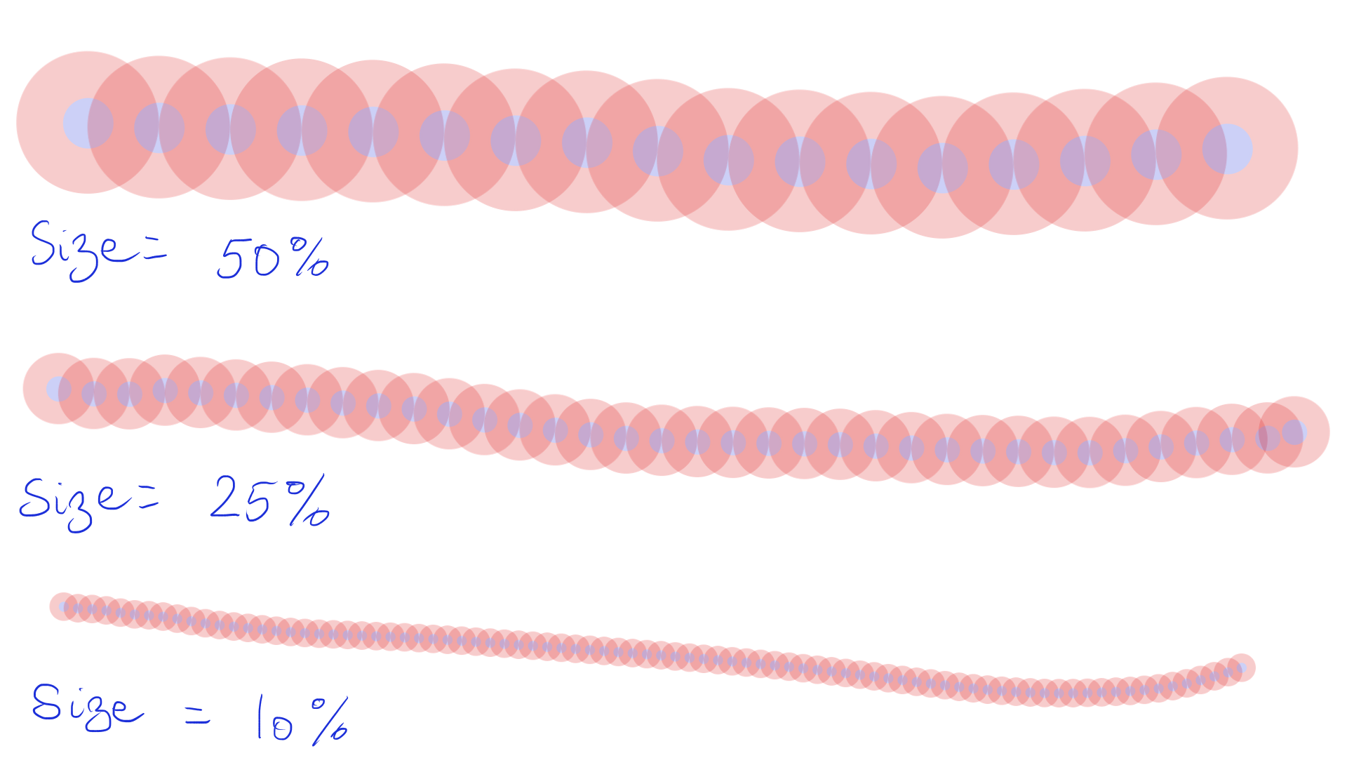

I may be wrong, but here it looks to work perfectly in my case :
Step = 50%
Step = 50%

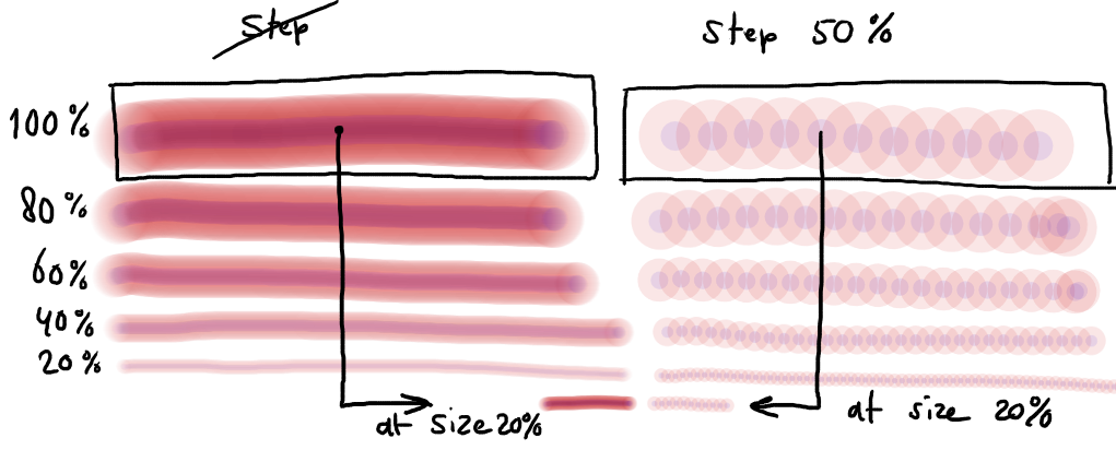

Elodie wrote:I may be wrong, but here it looks to work perfectly in my case :
The attachment step_size.png is no longer available
but in your example you don't show the influence of the step value
which is considerable.
two brushstampdowns at 100% (so without downscaling) and without a stepdistance, are 1 pixel apart and have, relativly, a much bigger overlap then smaller (downscaled) brushstampdowns that are also 1 pixel apart
you could also say, at low step value, the larger sizes are relatively closer to each other and therefore more dark.

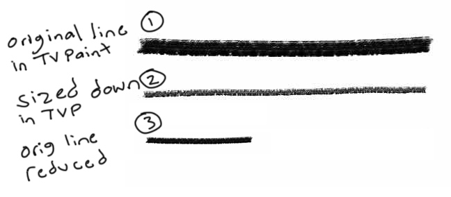

Peter explains it very well and you can see it in the image I posted previous and will post again here. In both Sketchbook and Photoshop, changing the size of the brush automatically changes the other parameters as well, notably the stepping. This means that any brush you design can be resized reliably. In TVPaint, I can't do that. I'm guessing that is an oversight, not a design feature. The work around is to redesign brushes for different sizes. Many factors need to be adjusted including wetness, opacity and even the whole design of the brush, just to get a thin line to match a thick line in look.
In my picture, line 2 is what TVPaint does when line 1 is reduced. It should look like line 3, which was reduced by grabbing line 1 and shrinking it down.
I get that this is not a bug, because a bug means software malfunctioning. I call this a design flaw which, in my view, is a critical one for people like me who are trying to use a particular line. It's is one of the huge draws of a bitmap program like TVPaint over vector software and as I say, Photoshop and Sketchbook recognize the need to adjust settings in proportion to the line size. Even if we could adjust the stepping below zero, then I could fix it myself. Maybe that's an easy fix? If it is, I would just love it if it could be done. :)

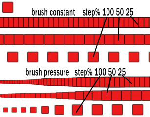

David_Fine wrote:As I play with this, it feels like it is the stepping which does not size down... The steps need to reduce with the brush, but how??
step a percentage of brush size.png (27.19 KiB) Viewed 27942 times
I'm not sure what the problem is with how you are defining your brush, but in my brush-making experience, I've set step size with an understanding that (when checked) the interval will always be a percentage of the BRUSH'S SIZE, meaning that if the brush size varies with pressure, then the step size will vary as well.
Please be careful in what changes you request about brush construction. There are literally thousands of custom brushes in use which were built using the current parameters. In all fairness, any changes in future brush definition should not impact those in any way.
