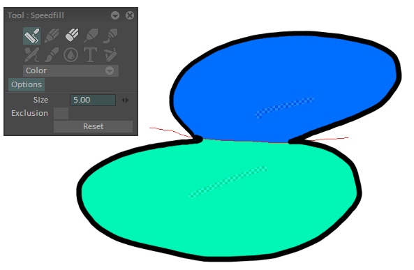

Peter Wassink wrote: i'd like to request an extra tool in the color & texturelayer panel where a close gap tool is added to the Speedfill toolpanel and you just put thin UI lines to closeoff leaks.
The lines (like the squiggles) will not be visible in render or when the C&F layer is off or inactive
In fact, this is exactly how you do it in Harmony. You just paint invisible lines to define the areas, as needed.
I haven't used Harmony that much , but doesn't Elodie's illustration ( viewtopic.php?f=10&t=9344#p86357" onclick="window.open(this.href);return false; ) two posts above yours
show something similar with CTG ? A carefully placed "squiggle" line closes a color area , but when the scene is rendered this line is invisible.
When i tried it it was hit and miss for me.
how do you fare, with it? maybe i'm doing it wrong. I think an option like this should be 100% reliable, painting animation is enough work as it is.

Peter Wassink wrote: When i tried it it was hit and miss for me.
This is exactly the issue I am having. Hit and miss. The link to the Lazy Brush page could be exactly what we need, so I will look there, but I wish this info was available on the TVP site in the first place, otherwise users have to rely on finding it in the forum.

David_Fine wrote: 25 Sep 2015, 23:06
Peter Wassink wrote: I'd like to request an extra tool in the Color & Texture layer panel where a close gap tool is added to the Speedfill toolpanel and you just put thin UI lines to close off leaks.
The lines (like the squiggles) will not be visible in render or when the CTG layer is off or inactive.
I don't know if this idea of Peter's ever got added to the requested "To-Do" list , but I still think this close gap tool for the CTG would be a good feature to have.
EDIT: oh, yes, I see now by doing a search that it was posted in the Feature Requests. I'm going to revive the request over there.
https://www.tvpaint.com/forum/viewtopic ... ool#p86330
